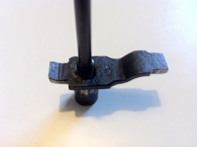

Speaking of internals, on my M53, the locking mechanism that secures the butt stock to the buffer was REALLY tight, you couldn't just push the button by hand.
Anyhow, I managed to get it all apart and it turns out the metal tab that locks into the notch on the buffer, was a little too wide, so I took my honing stone to it until it moved freely.

Well done and Thanks for sharing the parts pics.

Thanks. I finally got everything put back together. Mines tight just like you mention. The gun I bought came with an M53 stock but no guts in it. I now suspect that those are the guts in my MG42 stock and he didn't tighten them because they stuck just like you mention. I'll take another look and see what I can do.

I think the locking tab is hardened steel, so you'll probably have to use some kind of abrasive stone to make it fit, rather than a file. Just keep honing the sides of the locking tab until you get a nice fit.an1913t wrote: ↑Tue Dec 07, 2021 8:36 pm Thanks. I finally got everything put back together. Mines tight just like you mention. The gun I bought came with an M53 stock but no guts in it. I now suspect that those are the guts in my MG42 stock and he didn't tighten them because they stuck just like you mention. I'll take another look and see what I can do.
