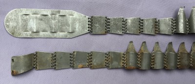

Ammo belt I’d please MG34?

The links that fully surround the cartridges like that means that the cartridge had to be extracted from the belt by pulling it rearward. The only German guns I know of that do that are the Maxim series - the MG08 and MG08/15.

As for the markings, the "S" corresponds to Suhl's well-known firm Simson & Co, the droop wing eagle above the number 46 is the inspection/aceptance marking and the numbers may correspond to December 1930.
