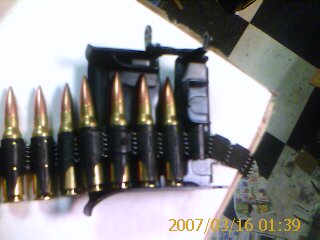

The MG1 feed tray is basically a 8mm feedtray that has a spacer gate welded in to fit 7.62.
I don't think the tray needs lengthened.
I agree on this, take a std 8mm tray, weld a spacer on the front for the 7.62 x54, then pop the empty link support piece out and either move it forward or shorten it?
I'll study into it myself tomorrow if time permits. I might make one up and offer it for sale if anybody is interested. Basic used M53 feedtray + labor and shipping.
MG1 7.62 feedtray pictured
- ft.jpg (17.45 KiB) Viewed 8160 times
