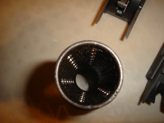

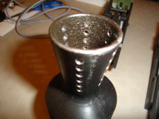

Whats wrong with this as a brake? Just trying to follow the letter of the law here in Kali.

Might have problems with dust/dirt being kicked up by the downward facing holes. Then again, it might not be a problem. Just a thought.
I thought those were called flash hiders, not muzzle brakes. The ZB-26 and ZB-30 have the same style and they're called flash hiders on those.... Drilling a bunch of little holes in a flash hider doesn't make it a muzzle brake.
A muzzle brake deflects some of the gas rearward to counteract the recoil of the gun.... thus "braking" the recoil. There are no ducts or deflectors on your style for that purpose. Holes help reduce the flash by allowing the unburned powder to get oxygen faster to burn off, thus reducing the flash duration. Which, by the way, is supposed to help hide the flash from the shooter, not hide the flash from the shootee.

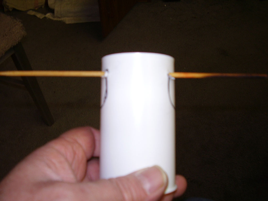

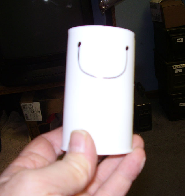

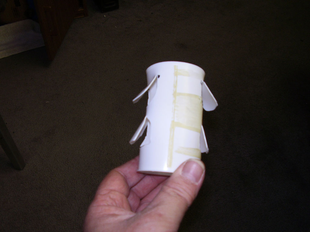

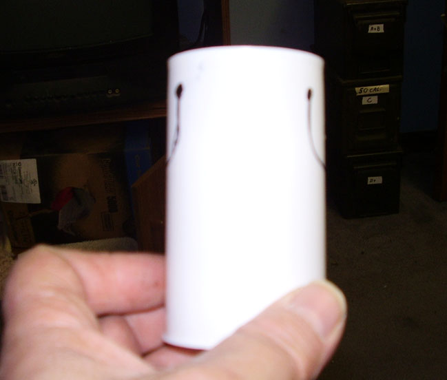

The sides of the brake where the flaps are - let's call that a U shape (although it's a squared U) With the muzzle brake pointing up: mark two squared Us on the tube - one on each side. Drill a 1/8 - 3/16" hole at the tops of the U on both sides of the tube which will become the brake. Feed a scroll saw blade through the tube, through one hole of what will be the front flap on left, and the front flap on the right. (See the picture.). As you look at the brake, the blade would go through the top right on one side, and the top left on the other. Mount the blade in the saw, put on your safety glasses, and cut the penciled U shape into the tube, down, across, and up the other leg of the U to the other holes. Remove the saw blade from the tube, and do the same thing again for the pair of rear flaps. Afterwards, heat the flaps with a torch till they're red and bend them out with a screwdriver till you can grab them with a pliers. Bend the flaps till they're evenly bent out. Holes, flaps, cheap, easy..... :mrgreen:
Those are the basics as I envision it. Make the rest of the brake as is shown in the manual, and it shouldn't be a major task. I made my demo out of a plastic bottle. What do you think?
run the scroll saw blade through the same side of both U holes.  Cut and bend.
Draw the U shapes on both sides, drill holes at the tops of the U
