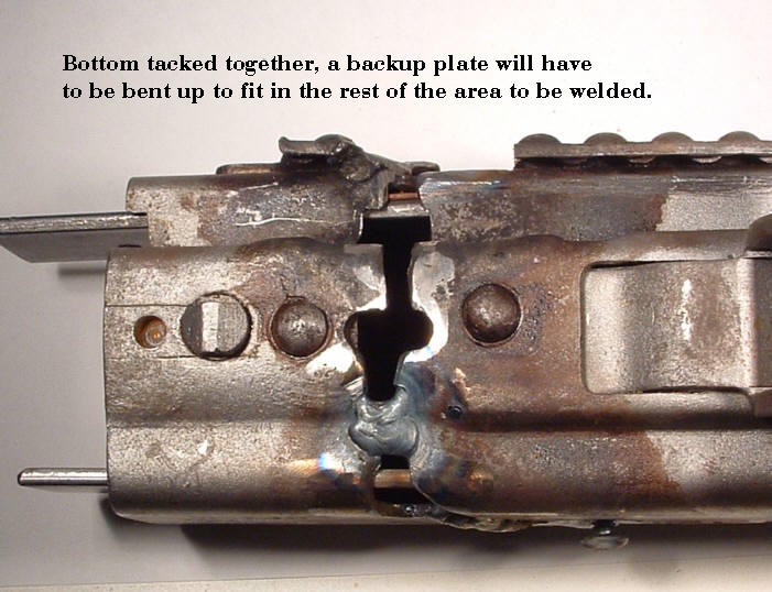

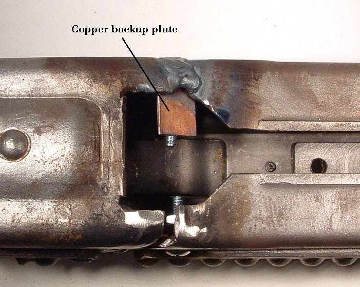

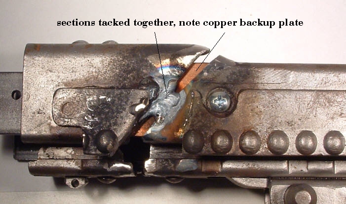

Now the receiver is ready to weld. I installed the feed cover to set the length of the receiver.
I also checked the length against the drawing. not all dimentions match, but the cover fits,
So I will work from that. The sttel plates align the sections and also hold in place copper plate
to back up the weld. This prevents weld filler from protruding inside the receiver.

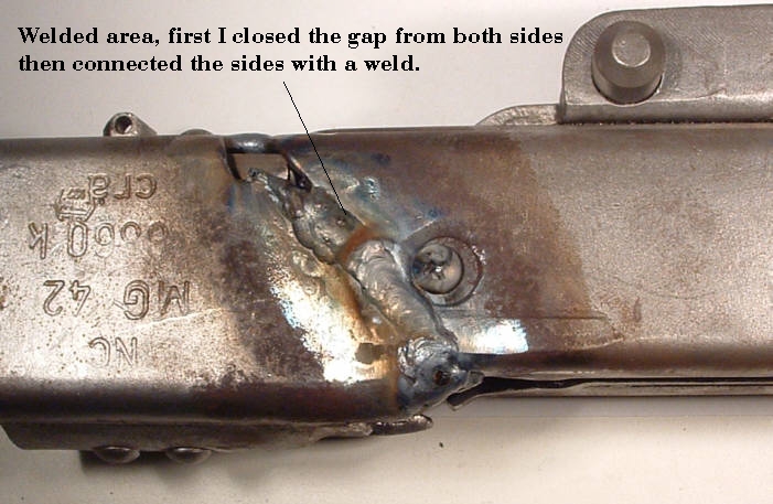

In order to reduce warping and shrinkage I welded a pass on each side of the torch cut to close
the gap, then did another pass to weld the sections together. This gives good penetration and
eliminates undercutting at the edge of the welds.
I tacked one side, checked the alignment and tacked the other side. Then tacked the top
and bottom. As you can see in the photos there are some areas that will require a lot of
filler.
After the sections are tacked together and you are satisfied it is straight, make some formed
copper plates to fit in the bottom to back up the weld. This area can't have weld protruding
filler.

- bottom of receiver
- mg4212.jpg (227.97 KiB) Viewed 16865 times

The welder is a Harbor Freight TIG, I got it on sale for $199.00. In addition you need a regulator, $39.00, tungstens and collets, and a plug. It cost me about $400.00 for everything including gloves, rod and a shield. I am renting an argon bottle.
The copper plates are sandwiched between the receiver and alignment bars.

1. if you build up the edges it is a lot more work, and you introduce the potential for more error.drooling idiot wrote:I suggest as an alternative to tacking it together and THEN filling the large gaps , try building up the individual sections while they are apart .
This method ...
1) gives you the ability to manipulate the torch into positions that are very awkward or impossible when its together.
2) lets you use a thicker backer bar early in the process so you can use a little more heat where the old meets new for good fusion.
3) makes it easier to grind and clean the prep welds , especially inside.
4) makes filling the small gaps still left almost fun .
After the large gaps have been filled then line the parts up and tack into one piece.
I've had good luck lining the pieces up with just a stupid string line and some patience.
2. the purpose of the backer is to prevent oxygen from reaching the back of the weld and to support the weld.
It doesn't have to be thick copper, the thinner the better as it is easier to bent to fit corners.
There are no Awkward positions, just rotate the receiver.
3. doing it this way lessens the amount of grinding.
4. by laying indivdual passes it gives 100% penetration with less heat..

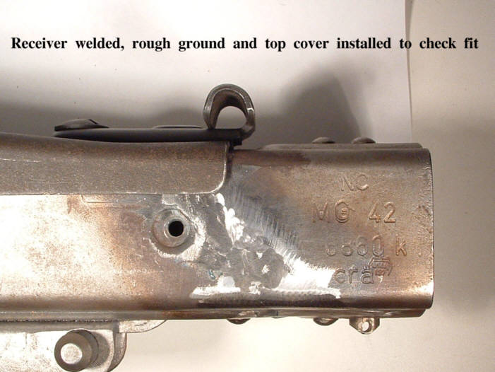

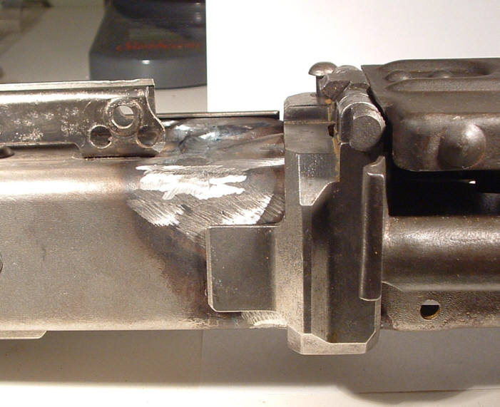

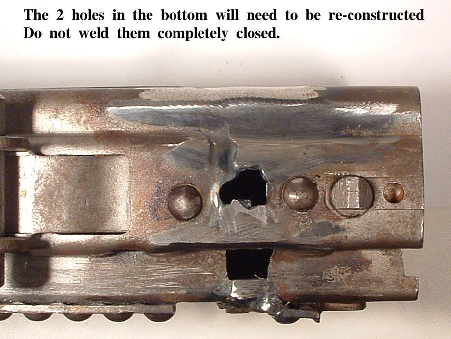

Here are photos of the rear section welded and rough ground with the feed cover installed
to check fit. The 2 holed in the bottom will need some extra attention and will be finished later.
It is a good Idea to test fit the parts as you go.
- rear receiver section welded & rough ground. feed cover test fit.
- mg4216.jpg (52.41 KiB) Viewed 16577 times

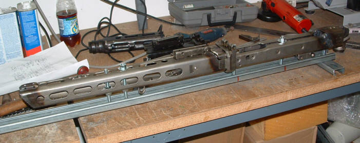

When I got ready to attech the front section I found that using the rails I made
wouldn't work, so I cobbled together a jig to align and hold both halves. All it is is a peice
of unistrut and 4 3/8" x 3" bolts some nuts and flat washers. I bolted the rear secton on and
then aligned the front and bolted that tight. It made the job a piece of cake.
- receiver jig.
- mg42jig.jpg (23.77 KiB) Viewed 16549 times
- gun on jig
- mg4223.jpg (43.31 KiB) Viewed 16552 times
- gun on jig
- mg4224.jpg (30.69 KiB) Viewed 16549 times

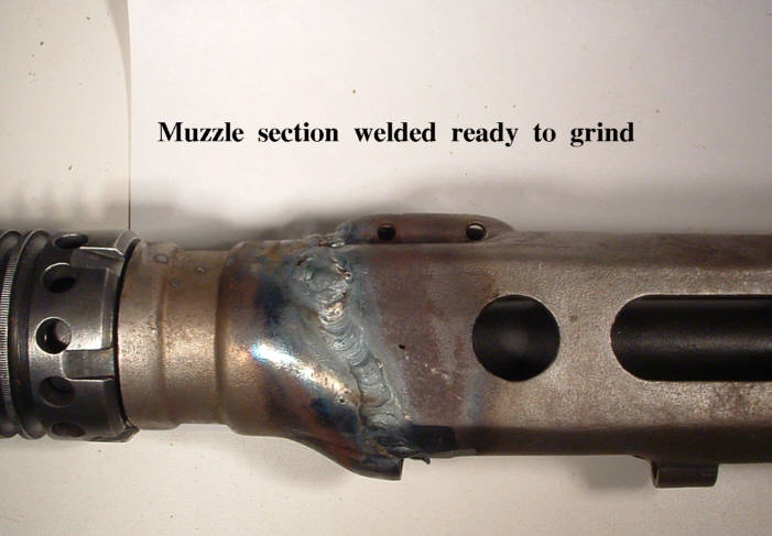

With the trunnion installed I installed the barrel to align the front section. It didn't seem to
align properly so I tacked it in place and tested the barrel for free movement and checked
the over all length, it measured 37 11/16 which is supposed to be correct., so I finished
welding the front section.
- front section finish welded.

Now the receiver is all welded, it is time to reconstruct the ratchet plate. I have opted to
do this rather than replace the whole plate as I don't have a spot welder and seems like
less work. I will clean up the area , grind the welds and put in a small section from a scrap
plate. This is where the brp cut pieces are usefull!
- ratchet plate to be reconstructed.
- mg4228.jpg (69.69 KiB) Viewed 16381 times
