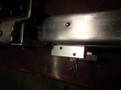

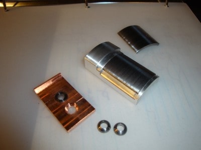

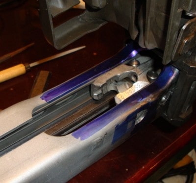

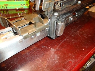

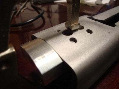

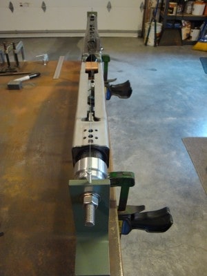

Spent the morning setting up and joining my receiver . Ended up using uni strut jig for tacking while rotate jig was mounted for stringlines. After tacking removed assembly from uni strut and welded between centers. Really nice to be able to rotate and weld oppsing sides to counteract pull. Didnt see any significant warpage. Copper backer jig kept the inner walls flush. Mounted the recup. and slid a rail in to check for clearance. Fit is good but have to finish up D-holes to nest rail. Top cover closes nicely after a little relief on side bumps. Next is the biggy. Install barrel and see where rails line up. Overall a productive day. later guys
- 1 sections-aligned.jpg (22.95 KiB) Viewed 42801 times
- 2 string-setup.jpg (21.43 KiB) Viewed 42801 times
- 3 Clamps-over-jig-for-tacking.jpg (26.08 KiB) Viewed 42801 times
- 4 finally-one-piece.jpg (30.14 KiB) Viewed 42801 times

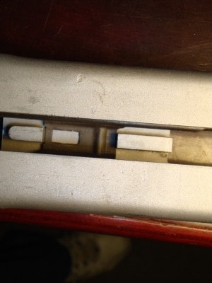

Been a month since I got a chance to work on my project. Finished the d-holes and fitted rails. Trimmed the tips a bit on cam end. "new mg3 rails" Line up great and centered on cam piece. Going to rivet rails but decided to weld buffer tabs. Made an alignment/heatsink jig for tabs. And same for faux rivet heads. Liked oakrodents idea but dont have a magna spot. Will be plug welding tabs and rivet heads. Also 4 outer spot welds as on original will be plug welds. Still lots to do. 15 deg. bevel on slot next. etc. Good to be back at it. RR

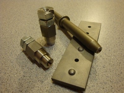

Made some rivet bucking tools today and tried on a few rivets. First one I got a little too hot and the head pitted a bit but second worked out better. only have one more spare. Used 5/8 ss hex stock and 7/16" bolts with 5/8" heads which fit perfectly in the rails. Ground radius into air chisel tip with a dremel stone while spinning in the lathe. matched to factory rivet head. Not using air hammer but bit was handy and hard. Hopefully have the rails mounted this weekend.
RR

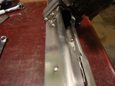

Another month gone by. Managed to mount my rails today. Must have installed with screws and removed a couple dozen times along with recup. Before I was happy with alignment. Then drillet to full size. Recup. removes/installs easy now. Had to make it a bit looser fit in the semi blocker. Was zero clearance tight. Ended up using tig torch to heat rivets at low amperage. Then form while tungsten burns into leg.
. Set up a torch holder after that. Still it would be better with two people as rivets cool fast.
Fitted fcg to receiver. Had to mill about .020" from rec. bottom to mount. Made for a flatter surface too. Ready to assemble it to grip now. Welded up bolt extension and it centers within rails onto buffer very nicely. Also bolts slides down rails and into barrel effortlessly. It should I spent enough time centering each end.
Question, I read that mg3 top cover spring should be removed for semi build. I want to use starter tabs with cover closed. Cant you just hold back c/h, pull tab to second click and let go? Really want to add a bolt hold open that is independant of c/h. Dont like it slamming forward with bolt too much.
Next up mount ratchet plate and finish fcg. Didn't expect to spend over six month on this build. Really about a 40 hour project.
RR
