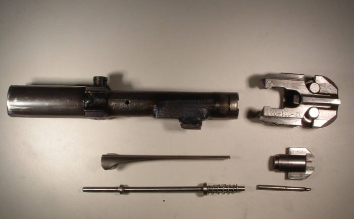

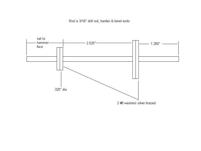

Finally made some progress today. I tried using the 3/16" dia firing pns I made. I didn't use them
because I thought they would be to heavy and they fit kind of tight. After messing around with
this thing, I learned several things.
!. the firing pin needs to be the right length, if it is to long it will bind whan hit by the hammer.
2,. the ejector extension needs to fit properly or it will cause binding, even if it seems loose.
3. the hammer must strike the pin squarely on a flat face.
The pin design I got from some photos was overkill with the bushings, I used a couple of #8 flat
washers on the 3/16" pin. all they need to do is hold the firing pin spring in the front and
support the ejector extension in the rear.
After welding and grinding the hammer face several times I have it popping primers consistantly.
the firing pin nose could protrude a little more so I plan on extending it about another .025 or so.
I also ground the bottom of the bolt more to give additional clearance for the reworked hammer.
I have a grip stick and new hammer coming next week to grind to the proper shape.
I will head out to the range after work tomorrow to do a live fire test. If all goes well I will
post pictures of the mods with dimentions of the parts.. for those of you who want to buy the
conversion parts kit I will start getting prices on getting the various parts machined.

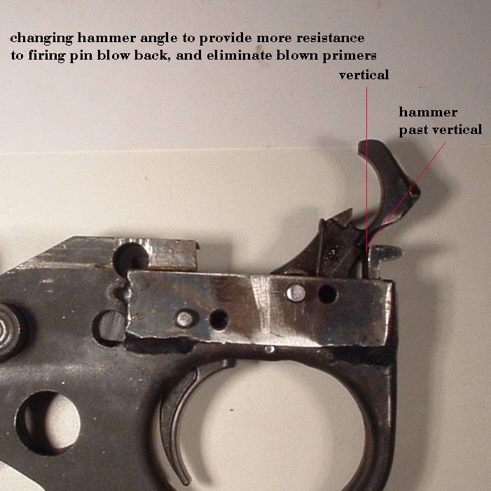

my first and easiest solution is to move the fcg back so that the hammer is forward of
vertical. the theory here is that the angle of the hammer will present enough resistance
to the firing pin to keep it in place after hitting the primer. this is based on the breech
locking mechanism of the luger toggle lock where the pivot of the toggle is below center
holding the toggle closed. hopefully this wilth a stronger hammer spring will solve the
problem.
This also puts the trigger closer to the safety, making it easier to modify the safety to work.
I have some heavier hammer springs and new hammers coming to redo this setup, hopefully
it will work and save trying to design a whole new fcg.

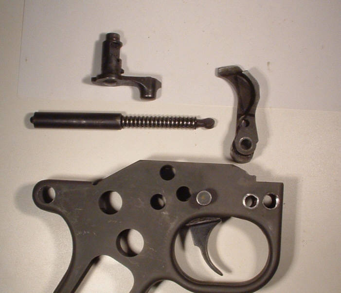

This is a photo of the FAL fcg, the trigger fits into the gripstick perfectly widthwise I need
to figure the proper location for the placement. the hammer will need some modification
to fit properly with the spring and plunger tube and to clear the retracting stud on the
bolt. the hammer is tall and beefy.

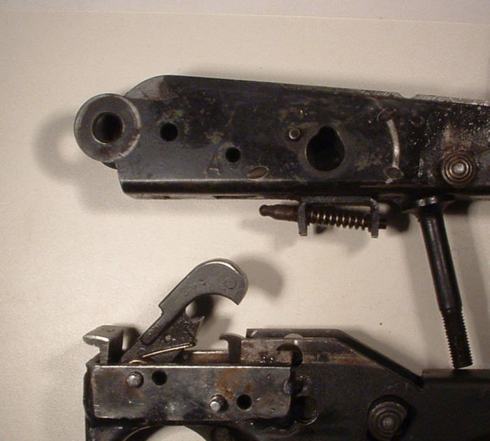

The first step to install the FAL fcg is to remove the front gripstick ears. they are
spot welded in 3 places. locate the welds, centerpunch them and drill them out.
after the ears are removed weld the holes closed. The trigger pin hole will need
to be welded closed also.

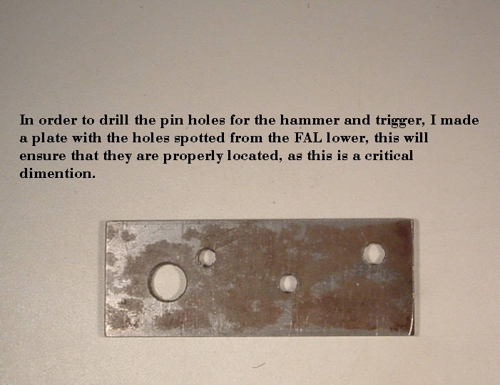

the FAL lower is a little wider than the mg42 gripstick, also there is a reinforcing plate
on the sides in the rear. This creates a clearance problem with the hammer spring
tube. to correct this about .125" needs to be removed from the left side of the hammer.
this will allow the tube to sit properly. I will also add a plate or washer on the left side
of the hammer to add some thickness to that area of the gripstick, as it is thin in that area.
The pins are grooved for a locking plate, regular "E" clips could also be used to retain
them.
I am also thinking of using the FAL safety. since it is designed to work with the rest of
the parts, I think it will work better than some modification of the mg 42 one.
Two plates need to be made, one to support the hanner spring tube and another for the
trigger spring and plunger. In addition a trigger stop of some sort may be needed, most
likely a small pin
Although this setup is a little more complicated than the AR fcg it has several advantages
over the AR parts. You don't need sideplates, this will allow the use of the origonal
parts for the lower dust cover.
The setup was designed for large rifle primers, it has a powerfull spring and heavy
hammer. This should provide proper, consistant ignition and prevent primer blowout.
- falfcg5.jpg (327.11 KiB) Viewed 13164 times

Do you think there will be any modifications to the bolt to use the FAL fcg? I mean if I had the bolt modified by huntsinmtns for the AR parts would there be anything else to have done to get the FAL parts to work? I think with this new concept of the FAL parts being used I'd rather go that route than the AR fcg...
Thanks!
Thanks!
~Matt

I have the gun ready to test again. The FAL fcg is installed after a lot of work, however I
think it will be worth it. I also made a 2 peice firing pin to see if it would work, also out
of despiration as I haven't been able to get acess to my friends lathe. The pin is a 3/16"
striker with 2 washers silver brazed on to locate the springs. I am using an original 42
firing pin, tests with primers give a good primer indent. the best yet, much better than the
ar even with the extra heavy ar hammer spring.
I also got a new recoil spring, it is la lot longer than the one that came with the kit, and
seems to work a lot better locking the bolt closed. I would recommend replacing your
spring with a brand new one. A worn out mainspring can lead to big problems.

This is the finished bolt with mods, I am using the spoon style ejector extension, the FA
firing pin and a striker rod. The rod is 3/16" drill rod, hardened on the ends with 4 #8
flat washers silver brazed on. the rear washer rests on the feed stud to limit rearward travel.
the front washer retains the fp spring. There are several advantages to using the original fp.
It is dimentionally correct, heat treated, cheap and simple to make spare srtikers.
It has performed well so far and I am happy with it.
The photo of the gripstick has the fal fcg installed. The hammer pin is retained by the receiver
the trigger pin by the grips. I installed a pin to limit trigger travel. It should work properly now.
I will be testing the gun in a day or two.

Hi Pirate! Terrific job you're doing!
Just a heads up on the FAL FCG - the FAL safety can be used, but it may be desirable to add a stop so it cannot be rotated to the 8 o'clock position. This is the rock'n'roll (full auto) pos and even though the gun will only go bang once while in this position, you will get a hammer follow-though and would require cycling the bolt to recock the hammer - kind of annoying when you're in the heat of the moment.
Cheers!
