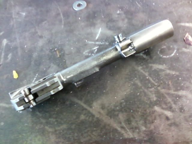

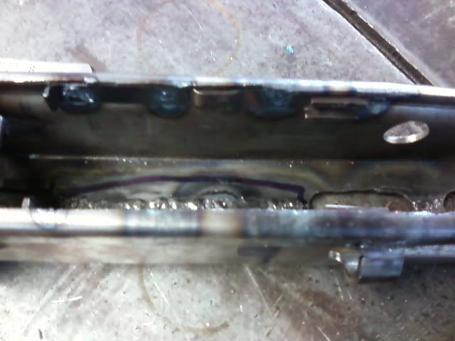

Rails welded in place, both align up perfectly to trunnion and barrel too. Bolt slides back and forth absolutely flawlessly :D . I will test my charging handle and what not in a few days. Awful busy with my final exams for this semester... :wnana:

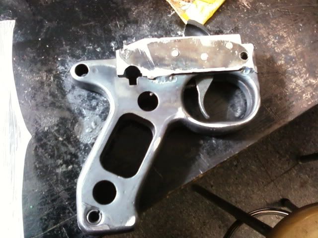

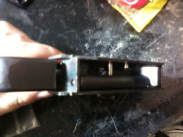

Got my FAL grip all made up, holy crap installing the sear into the trigger with that darned spring is a challenge all by itself :lol: ! Umm, and the pins supplied by Pirate for my hammer were like 1/8 too short, so they wouldn't even't even sit i my FCG box :shock:. Haha ah well, i pilfered this 5mm drill bit and cut it to size 8) . Oh man is that hammer spring a tough guy to depress! I had mocked up the parts, go to cock the hammer back, slipped and that hammer spring was like a mini rocket!
Also it seems i tacked my trigger plunger too far back! Now that the FCG box is fully welded onto my grip, fixing this becomes a bit of a task :/... The cons of buying the trigger parts AFTER assembling your box, so i strongly suggest that anyone who plans on doing your build with this grip, to mock up the trigger first! I will remove the plunger, weld on an extension, and trim it to the correct diameter on the lathe i guess. Should be a joy! By the way, metric C1 / L1A1 parts.

I will get some pictures up sooner or later. I also think i will need to re-enforce the welds holding my rails, as they are only tacks, and would probably come loose after a few shots!

All major components installed onto receiver :D ! I still must install front and rear sights, tripod lug, and rivet on the little thingy underneath the buffer that keeps it from twisting.
Used a spot welder to install the barrel door supports that i salvaged from cut pieces off of an old shroud (special thanks , you know who you are :) ). Installed the barrel guide thing and riveted on the barrel door. It currently isn't shutting properly (locking in), i suppose due to the angle which the door sits on, so i will fill the door locking piece until it slides back and forth smoothly!

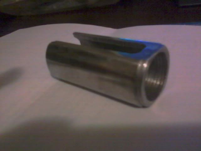

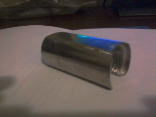

Well I opted to build my bolt parts myself! It took me a class to lathe the rear, but saved me like $40 :D. Here is a picture of it in its rough form, and below is are nicely sanded up-close pictures of it.
Gosh, now that I've the hang of it, I should make more to sell LOL :lol: ...
Anyways, i will start work on the firing pin sooner or later, and umm, I'm pretty much done! Just have to work out the bugs in everything and at least it will be functional (hopefully :oops: ). After it is all approved and whatnot, I will throw on the sights plus AA mount, and tripod lug. Holy cow, this has taken me a LONG time to do...

Thanks 42rock :D (got WAY to much grease :lol: ) , well my gripstick is officially working and ready to go as of today! Had to lengthen my trigger return spring, it was like a 1/8" too short! Just welded some material to it, and ground it to fit (very tedious to install and remove...). All thats left is to sandblast it, and then finish it, but I will do all my cosmetic work after my gun is functional!

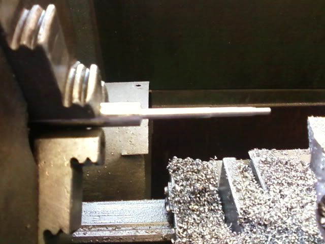

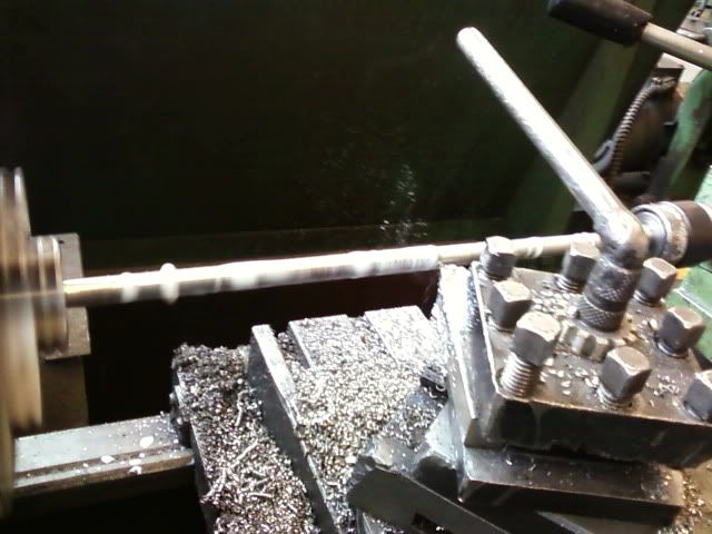

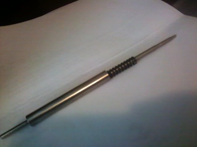

Took me 4 and a half hours, and a foot of drill rod to make this damned firing pin thing... I started with some 3/16" stuff i think, way to flimsy to just cut. I'm sure i was doing something wrong, had my carbide bit nicely sharpened, and was running at 200rpms. Normally that would cut through anything perfectly with auto-feed on, but it kept flexing the drill rod and bending it! So i stepped it up to some 3/8" stuff, and slowly (and evenly) removed metal , flipping it back and forth. Way too much work for the silly firing pin, what the heck was I doing wrong :? ???
Will weld some parts onto the firing pin, and weld the original pin to the end. Thank you Lima for your information you gave me!

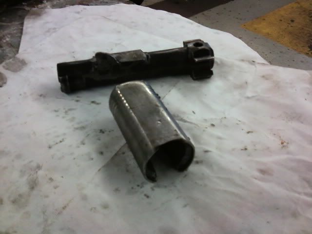

As for the bolt extensions, the inside of mine looks like crap! Dull drill bit :oops: :lol:, i will ream any future ones if i make a couple to help fund my projects. The inner and outer dimensions on Thompsonmachine.net are a bit off from what I found... Just a heads up to anyone planning on using the tutorial. Perhaps just because of my yugo bolt carrier?
I start by turning a 1.5" steel bar to 1.280" diameter
for a distance of 2.6" and drill a 13/16" hole 2.5" deep
Then its time to cut the angle on the inside edge that
matches the projection on the rear of the stock carrier.
I have found its easiest to just
set the compound slide to just under 6 degrees and
use the boring bar, checking the fit
after every pass. You will also need to turn the outside
diam of the first .10" to a diameter of 1.280 to
fit inside the spring ret ears on the original
carrier.
Can't quite remember, but i do believe the 2nd 1.280" should be smaller, to fit properly.

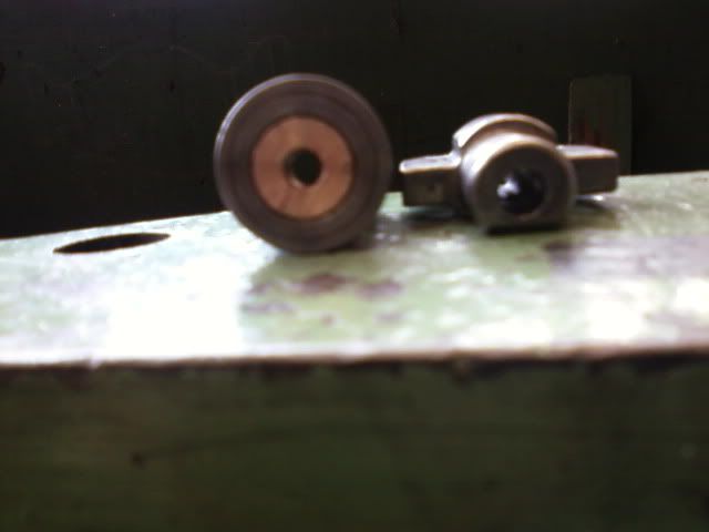

Well i figured out the solution to my problem today, redesigned and made a new firing pin, heat treated it, then made a support insert.
First of all, what I did was left the original OD of like 3/8 in the chuck , and turned it down to firing pin diameter half an inch at a time. each time stopping the lathe, and advancing the rod.
My firing pin fits perfect, and is quite similar to the BRP one dimension wise, although my spring-stop sits 1/16" farther back than BRP due to a calculation error :oops: ... Didn't make a difference though :D. Found this spring, appears to have an OD of 1/4" . Might have to cut it a bit down, and it is also tough as heck, i hope its not too stiff... WAY better than the one i attempted to make :lol:
Finally, made a support bushing by cutting down some copper round stock, and pressing them together, in the vice. Also drilled the other thing for the firing pin to go through. Mocked it all up, no binding or anything, all is good :D!
All thats left is to make that pin thing that holds the ejector-assist-pusher in, on the rear. Don't quite know how i'll drill it, but i'll figure it out :) .Then I must weld on my bolt extension, then done the bolt!
After this bolt, I just gotta work out the bugs on my gun, and should be ready for test fire!

Thanks for that link 42rocker, hmm, i could make something like that! I'll have to think up a way of attaching it to the lathe, i'll start making some drawings...
Bil, i tore apar 3 pens (broke, they didnt untwist, i untwisted like 5 :oops: ), and one lead pencil, and they are too small, I blame you!!!!! :lol:
