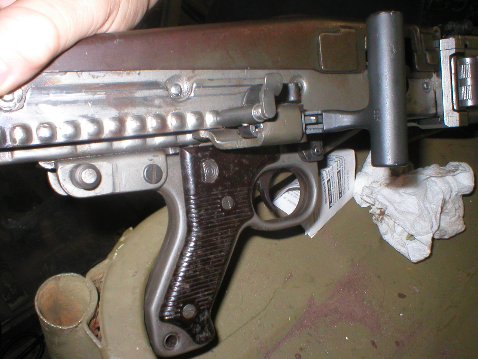

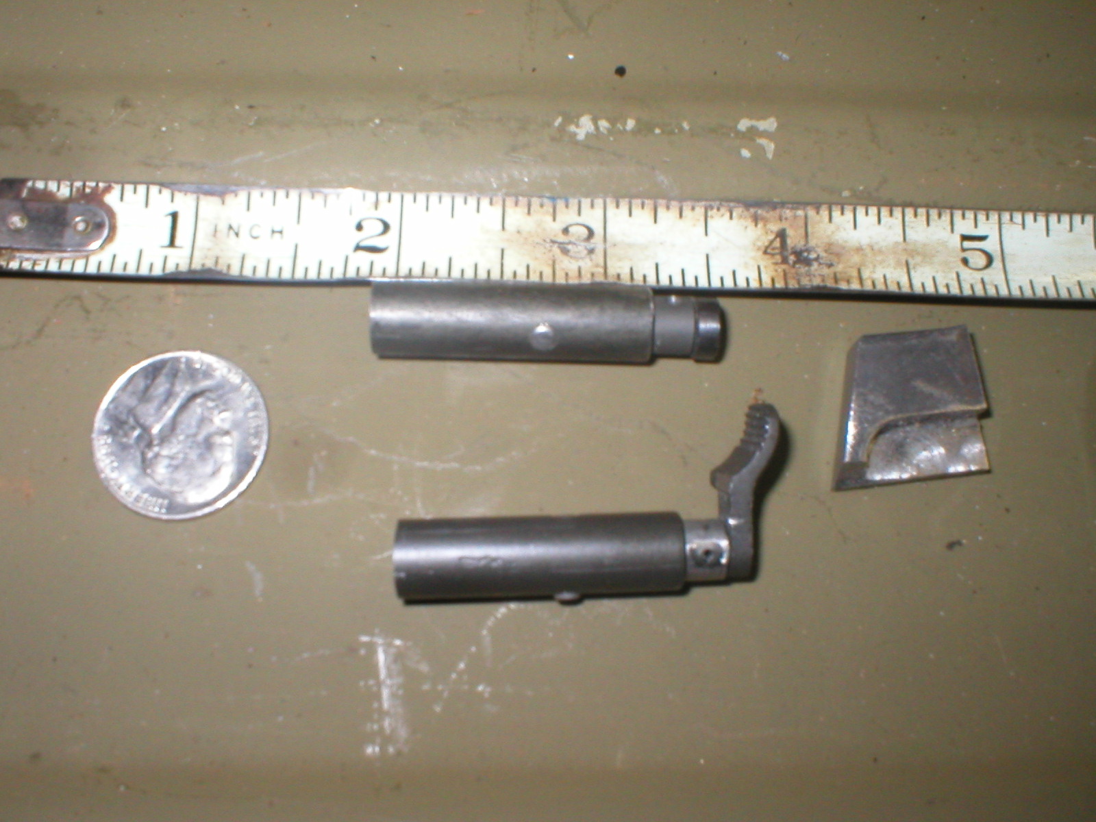

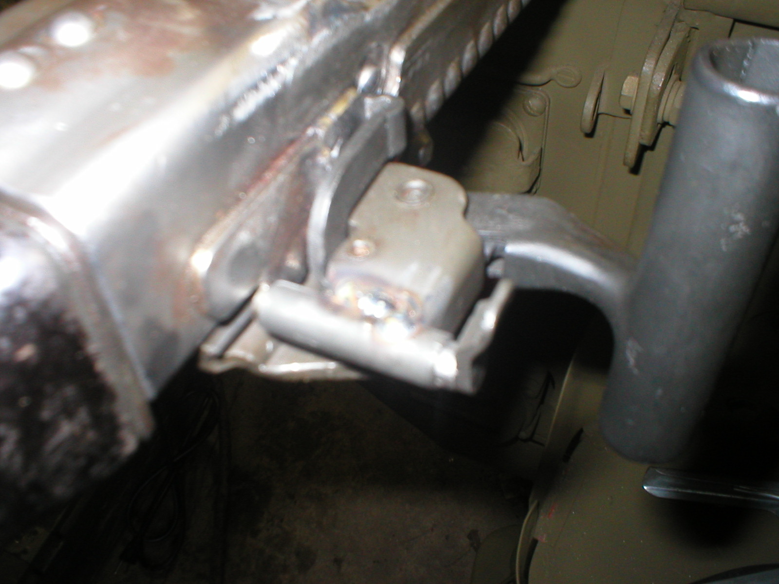

here are the pics from fjruple, his bolt hold open in both designes and the improved mount ear for pirates grip systm to allow use of the dust cover for the ejection port
- P9050018.jpg (371.38 KiB) Viewed 16292 times
- bolt hold extended
- P9050019.jpg (352.66 KiB) Viewed 16292 times
- holding open
- P9050020.jpg (340.27 KiB) Viewed 16300 times
- handle forward
- P9050023.jpg (369.28 KiB) Viewed 16306 times
- grip mount
- P9050021.jpg (356.85 KiB) Viewed 16346 times
Very clever design for the bolt hold open. What is attached to the receiver to engage the rod in the bolt hold open device. Is a tab welded onto the receiver. My receiver has the tab for the CH stop melted away when the receiver was torched. So far I haven't welded one onto the receiver yet. Right now I'm attempting to get to the "one pull of the trigger, one shot fired" mode.
the bolt hold is a springloaded tube similar to the other 1 for sale here but made from available parts, firuple will have to explain it, its his baby,he has no time to make em for sale but i am sure he would have no problem tellin you how to make your own
the one on the gun you can just kit it like a bolt hold on an ar or similar and the bolt runs forward, the one he made me has no big thumb pad so you just pull back the handle to unlock and let er rip, i had been thinkin bout these designes for a long time now just don't have that engineering mindset I guess
Some details about the Bolt Hold Open Device for the SA 42
Again I would like to thank Tom R. for helping me on my SA42. He did give his blood for my SA42 having cut himself twice on a small spring Without his knowledge of the semi auto conversion I would still be in the dark about some of the easy fixs and problems with getting this gun together and working. Alot of stuff on the SA42 is still in the work in progress. Tom thanks for posting the pictures. I will put the design of this hold open device for everyone to use as long its for their private use.
Items on your SA42 that you must have:
Your SA42 must have the end tab on the SA42 receiver where your charging handle enters the receiver from the rear. If you may have the tab cut or torched away you must rebuild that section of the charging handle track.
Parts needed to built hold open device:
Complete hold device for a metric based FAL (7mm in diameter). This includes the thumb tab, spring, plunger, hold open housing and a small roll pin. I order one from DPMS new and it came assembled. You can use an inch patten FAL hold device (9/32 inch in diameter) but I found that the pin in the hold open device is press fitted into the hold device and if you want to remove hold open device from your SA42 you will have to be able to disassemble the hold open device. I believe the metric is better for conversion.
You will also need the hammer spring plunger housing for a FAL. You will have to make sure that you metric for metric and inch pattern for inch pattern. The inside diameter of the plunger housing for the metric is 7mm and for the inch pattern the inside diameter is 9/32 of an inch. If you get the hold open device for FAL and hammer spring plunger housing for the appropriate inch or metric FAL you will find that the FAL hold open device will easily slide into the hammer spring plunger housing back and forth.
You will also need a 1/8 inch diameter pin about 1/2 inch long. This pin will hold the hold open device in the housing (hammer spring plunger housing) that will be TIG welded to the back of the charging handle.
Tools
1/8 drill bit
TIG welder
Dremel Motor Tools with cut off wheels
Step 1 - Modification to hammer spring plunger housing-- With a cut off wheel remove 1 1/4 inch of the hammer spring plunger housing from the OPEN end. You should have a round tube of 1 1/4 inch long with both ends open. Next drill a 1/8 inch diameter hole through the tube 1/2 inch from one of the ends of the tube. This end of the tube will be nearest to the thumb pad when assembled to the charging handle. Your hold open device housing is finished and ready for welding to the charging handle. When you weld this tube to the charging handle it pretty thin and you will have to watch for warping when you weld.
Step 2-- Modifications to FAL Hold Open Device- with a cut off wheel or grinder from the bolt notch at the top end of the FAL hold open device shorten the hold open device to 1 1/2 inches in length. Now this is IMPORTANT!! If you are using 8mm Mauser DO NOT I repeat DO NOT renotch the end of the hold open device. If you renotch the end of the hold open device as illustrated in the pictures that TOM R. posted the rear of the bolt will be inside of the 8mm Mauser feed tray. If you are shooting 7.62 NATO it does not make a difference since the front of the bolt is well behind the feed tray with the notched hold open device. If you have to assemble all of the internal parts for your new hold open device. Assemble the internal parts your hold open device.
Step 3-- Before welding may sure there is proper clearance between the new housing so that the handle on the charging handle will move and operate freely. After you have welded the hold open device housing to the charging handle make sure the hold open device moves freely through the housing. Take the 1/8 1/2 inch long drift pin and cut a notch in the middle of the pin. This pin will keep the entire hold open device in the housing and provide spring tension on the hold open device. Once assembled to the welded housing on the charging handle you should easily push in on the hold device and it should stop on the track on the charging handle.
If for any reason you have to disassemble the hold open device you will have to push the small roll in the hold open device assembly out to take off the spring tension off of the spring plunger in the hold open device which is retaining the 1/8 inch drift pin in the housing. Do not try to punch out the 1/8 drift pin with the hold open device assembled you will damage the spring plunger inside of the hold open device. Then you can remove the hold open device from the housing on the charging handle.
Total cost of parts about $20.00 Time: about one hours work not including welding.
Well that's it!! If you should have any questions please let me know.
