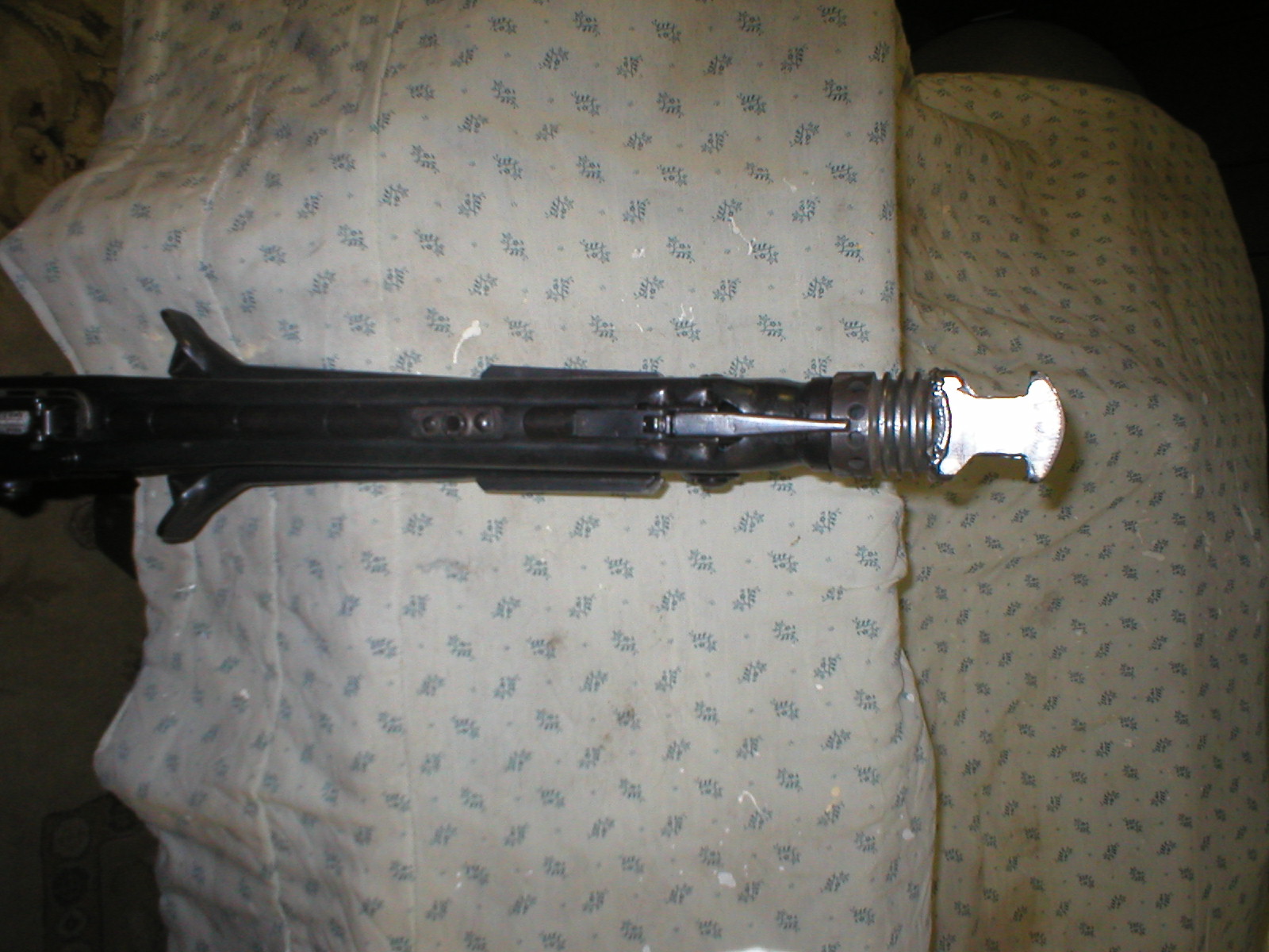

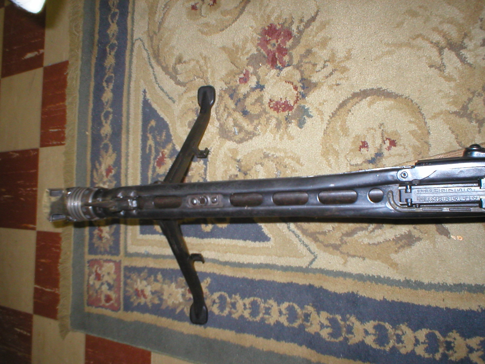

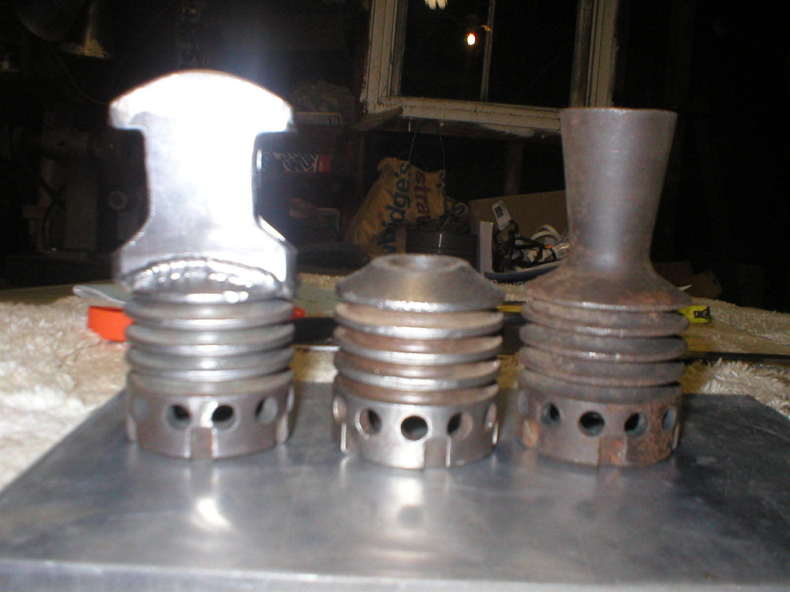

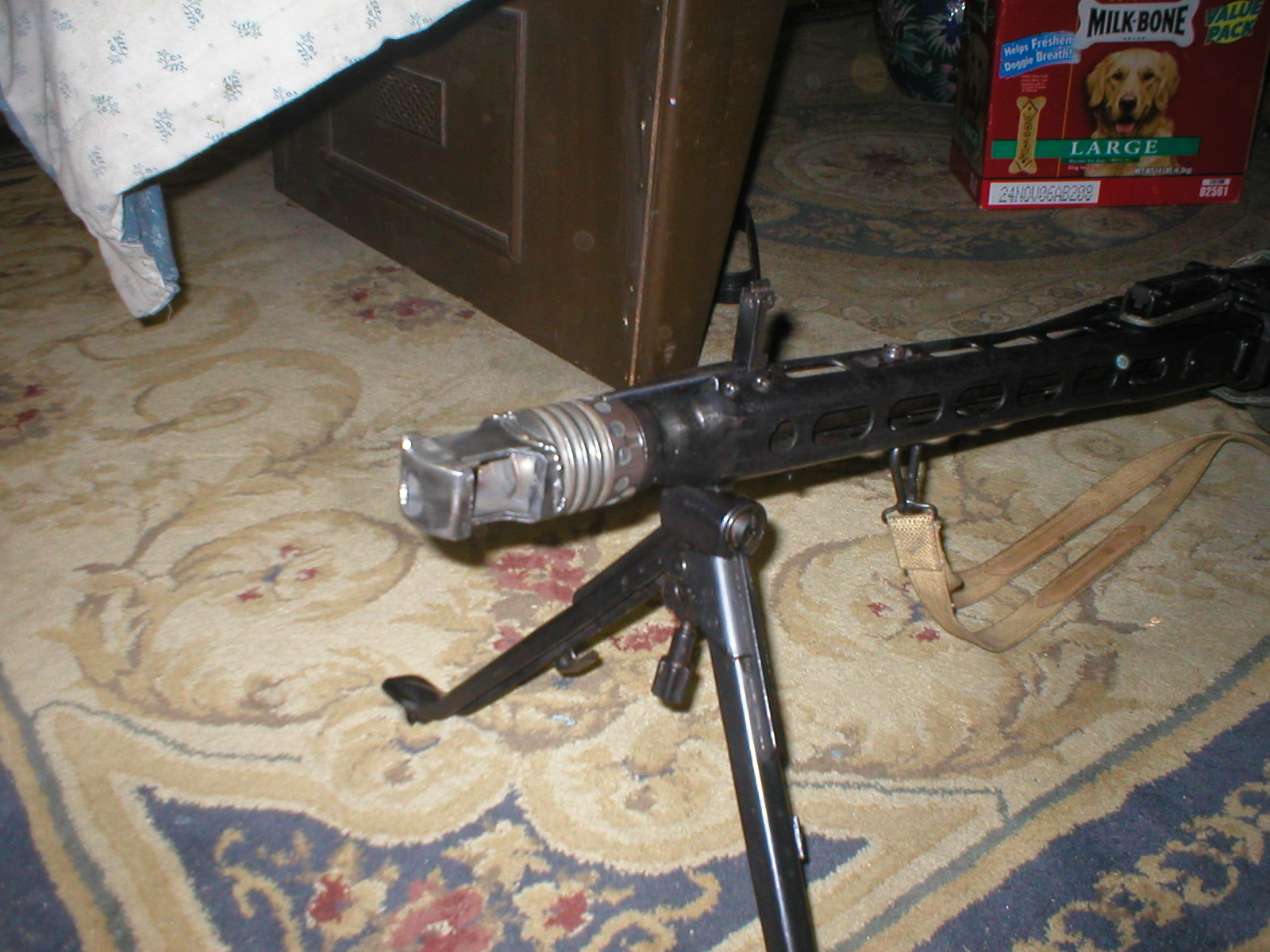

ok guys this is my version of the early mg42 muzzle brake as seen in the D166/1 manual laST PAGE i AM gonna make 1 or 2 other brakes also and may offer these for sale need to see if the time to make em is worth what i can charge, after some cleanup this is a prototype and each 1 will be hand made 1 off
