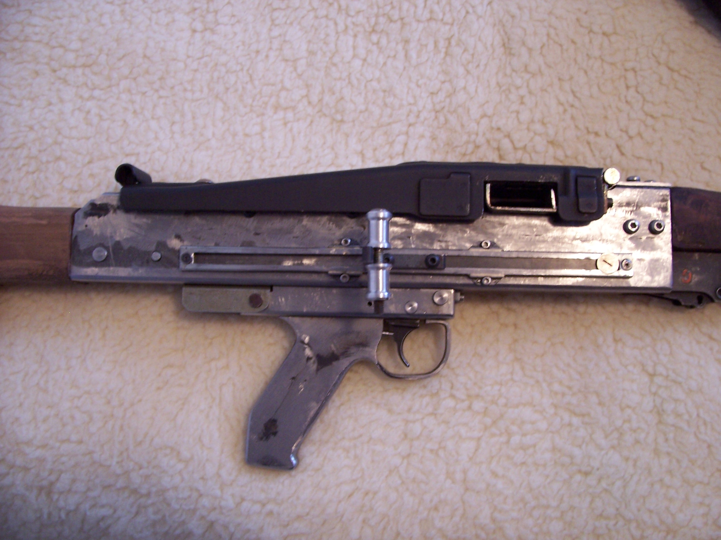

ADDED AN OPERATING HANDLE
REDUCED THE FEED PAWL TO FEED TRAY DISTANCE.

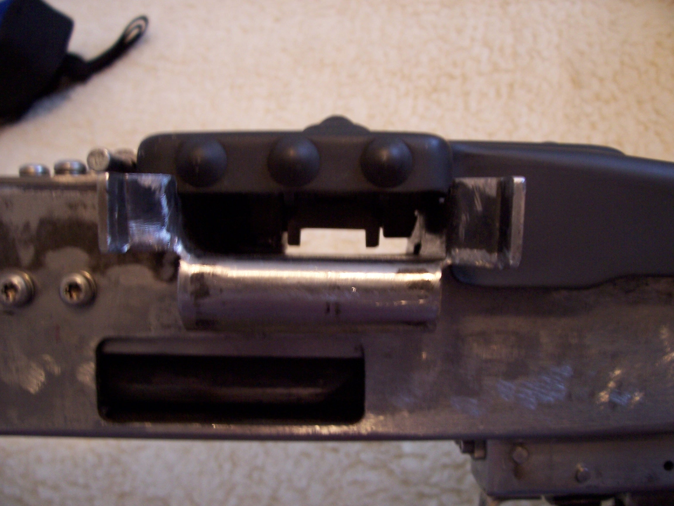

EJECTION OPENING VIEW AND FEED TRAY.

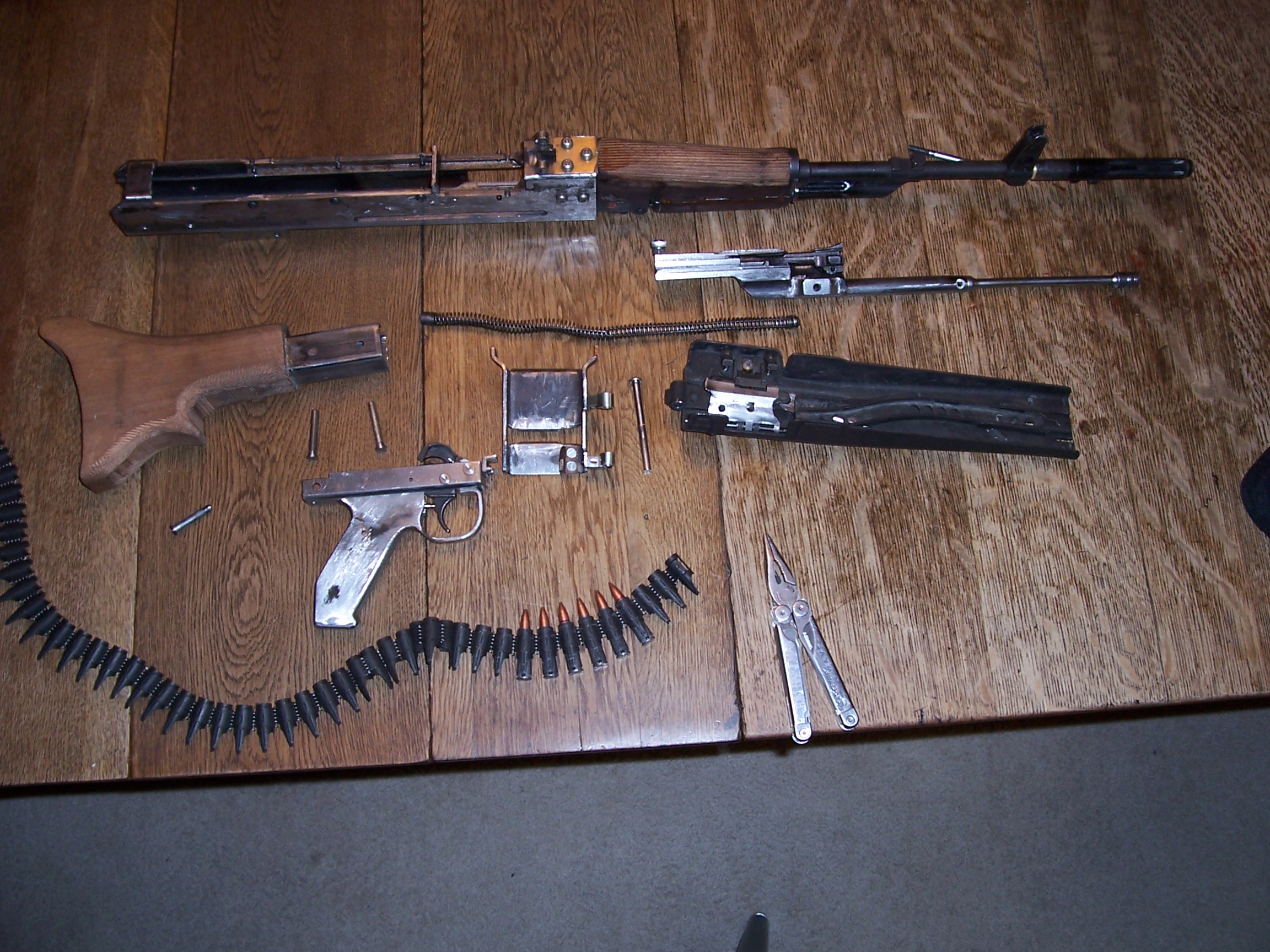

This weekend I got the fire control group working. I milled a slot for the FAL hammer in the extension piece I welded to the back of the stock ak-47 bolt. I then made a new firing pin slightly longer that the stock AK pin with a shoulder on it for a firing pin return spring to prevent a slam fire. At first it took 2 hits of the hammer to set off a primer. I turned the shoulder down to reduce the weight and it works fine now. I will post some imaged of what I did A.S.A.P.
I tried an AK bolt carrier return spring but it wasn't strong enough to strip a dummy cartridge from the belt. I then tried a FAL carrier return spring. Better but still not strong enough. I bid on and won a M-60 spring on G.B. and it should be strong enough. Should receive it this week. Just have to make room for it by opening up the hole in the butt stock and turning a new end for the bolt carrier end and welding it to the bolt carrier.
I will keep posting up dates as I make them and get some images attached.
Assembled view
Assembled view
dissasembled view
dissasembled view
cocking handle attached

Will be interesting to see if there are problems feeding and ejecting from the same side. Do you think a 50 round drum will get in the way of the ejection port?

Cycling by hand has not presented any ejection problems so far. It ejects very low through the ejection port below the feed tray. Throws the cases about 30 degrees form vertical downward. I have a small round metal container about 4 inches in diameter with a snap on lid that I plan to make a feed drum out of. I should sit high enough above the ejection port to not present any problems.

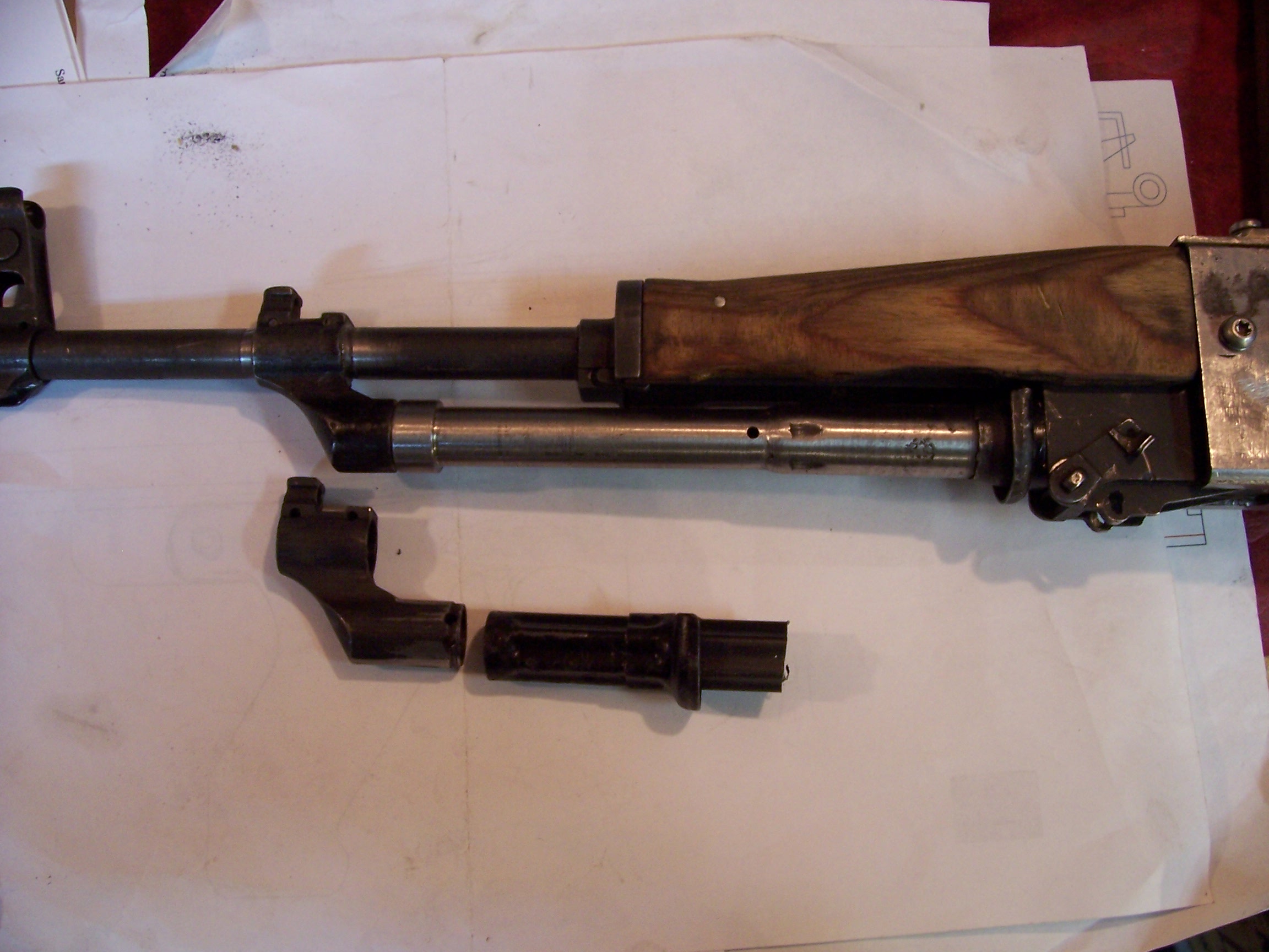

Here is some pictures of the latest progress I have made on my MG47 (belt feed AK). I modified the standard AK gas block by cutting off the gas relief holes and turning the neck down concentric with the inside diameter. I made a new heavy wall gas tube with the gas relief holes where the gas piston almost reaches the end of it's rearward travel. I then cut the standard AK gas tube in half and welded it to the new forward section.

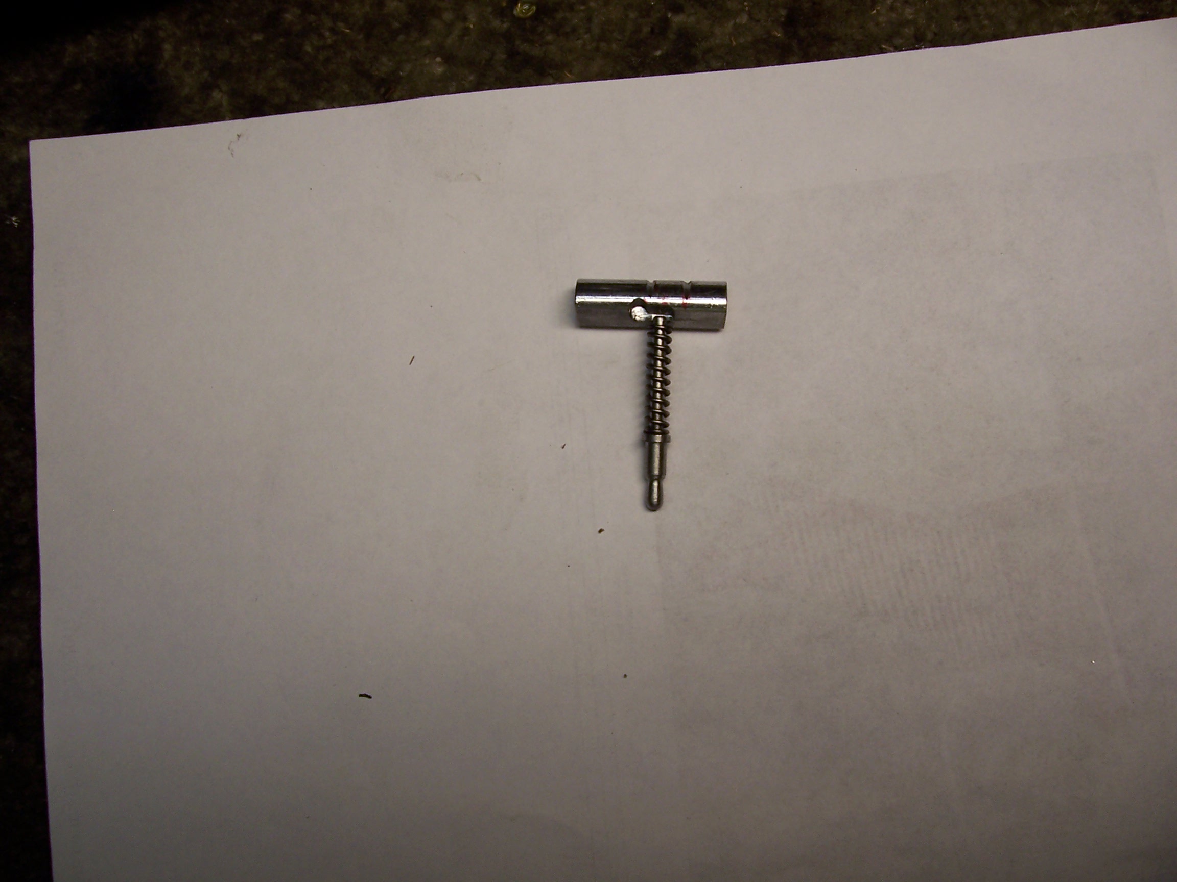

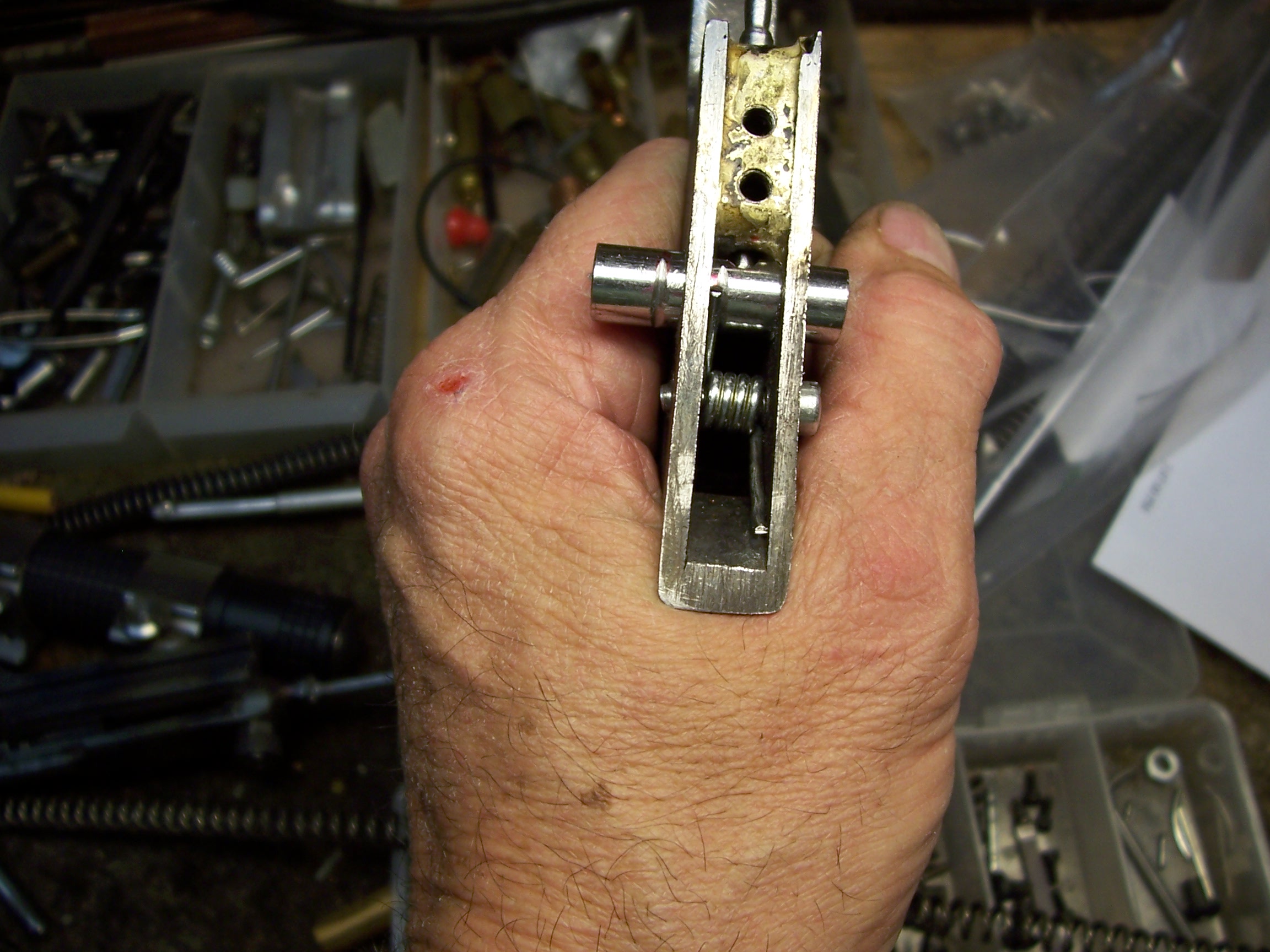

For a safety, I made a pin about 3/8" in diameter with a slot in it that the back of the FAL trigger spring plunger rides in. In the safe mode, safety to the right, the trigger plunger bottoms out in the slot preventing the trigger from moving. By pushing the safety to the left the back of the trigger spring plunger can fall into a deeper slot in the pin and allow the trigger to move the sear and drop the hammer. There is a torsion spring end that falls into 2 knotches in the safety pin to hold it in safe mode or fire mode.

gas tube and standard gas block next to the modified gas block.
new gas stube installed.  Notice new gas relief ports.
view of the safety installed and in the fire mode. Torsion spring end in knotch to hold it in FIRE mode. OUCH, SCRAPPED KNUCKLE!
FAL trigger spring plunger in the slot in the safety plunger in the safe mode.
FAL trigger spring plunger in the deep slot in the safety plunger allowing the trigger to move and fire
