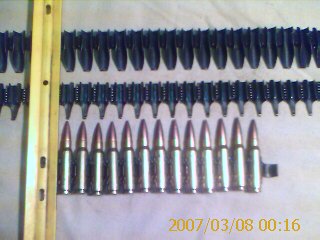

FAL_specialist
Post by FAL_specialist »
Use a VZ/UK 59 belt.
This weapon fires from a open bolt and pushes the round out forward through the belt similar to a 42. The rear of the belts cartridge holder/clip is slightly angled to slide the rimmed base out of the belt as its pushed forward.
The spacing of the belts are almost identical.
Heck, a M-13 link belt has 9 rnds whereas the DM1 belt has 8 rnds within that short of distance!
Some claim you can use either of these with no mods in regards to spacing!!
Larry
FAL_specialist
Order of belts
UK59 top
DM1 center
M-13 bottom
belts 1.jpg (20.61 KiB) Viewed 7202 times
propos
Post by propos »
Ok, where can I get a UK59 belt? I don't know how much a gunsmith would chagre to rechamber a .308. There is enough metal to di it. The Russian round is thicker around the case body and longer tnan a .308. The biggest hurdle is the belt. IF a UK59 belt will work, most of the battle is over. I wonder if CFS has belts. I know they are selling the kit.
