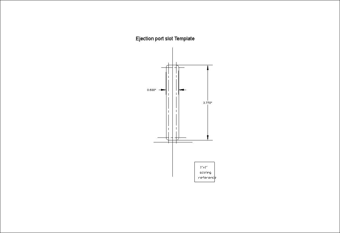

I have attached a copy of the ejection port template, can a few of you download and print it and see if it comes out to scale?
thanks
Little Rhody
Post by Little Rhody »
I have not been able to print it to scale. I tried doing this two differant ways. But I think the info is clear and could be easily be mocked up on the part to scale with the specs you have provided.
Thanks,
LR
I agree-I couldn,t get it to come out,but I am not too proficient with the computer.So I just used the measurements,added a radius,and made a paper template.Tried it on several receivers-worked fine!. ---bil

thats what I was afraid of. I have some other things to try, I will post a few different files later. If you guys would try iy out I would appriciate it.

Hi Pirate:
To print to size on everybody's printers, it needs to be a .pdf file. If your drafting program will "output" .pdf's then you can do it. If not....I can have a try with my program. Send me a .dxf or .dwg file and I'll see what I can do.

I found a site with a free .dfx / .dwg reader, it will print to scale. here is the link, download and install the program
http://www.edrawingsviewer.com/
I can't attach a .dfx file here , I will post it on my site tonight.

I just updated the cam section page on my site, I can't attach the dfx file format here. There is a ling to the reader and a link to the drawing, click on the link, save the fie, download the virewere and it should print to scale. I will have the rest of the templates posted in a couple of days if it works.

has anyone tried the program and template?
Village
Post by Village »
Pirate, the program prints the diagram to scale perfectly - thanks!

The program and template work fine....thanks again.
