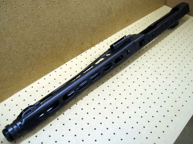

Back again.took some photos of the receiver after I started hacking on it (sorry!! :( ) Hope these help a little. I do have a question reguarding the grip stick mounting bracket: Can anyone give me the size of the opening that recuperator tabs fits into? the drawings I received are becoming more vauge as I progress.
Bill

Post by Sd.kfz.173 »
more photos

:shock: the rear looks to be off centered a bit......is it?
