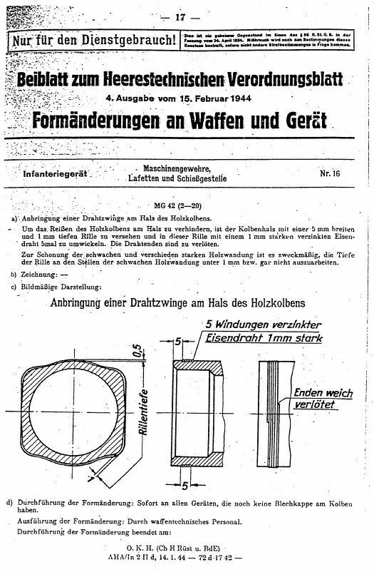

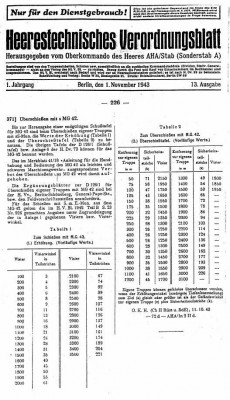

A couple pictures with some good information. Click to enlarge.
How to wire-wrap a wood MG42 stock for reinforcement
MG42 Overshooting tables

In the stock wire rapping, 1 mm wire over 5 mm should be 5 wraps?
A lot of German stocks seemed to only have 4 wraps as I recall

The information sheet speaks for itself. I won't try to explain it :)
