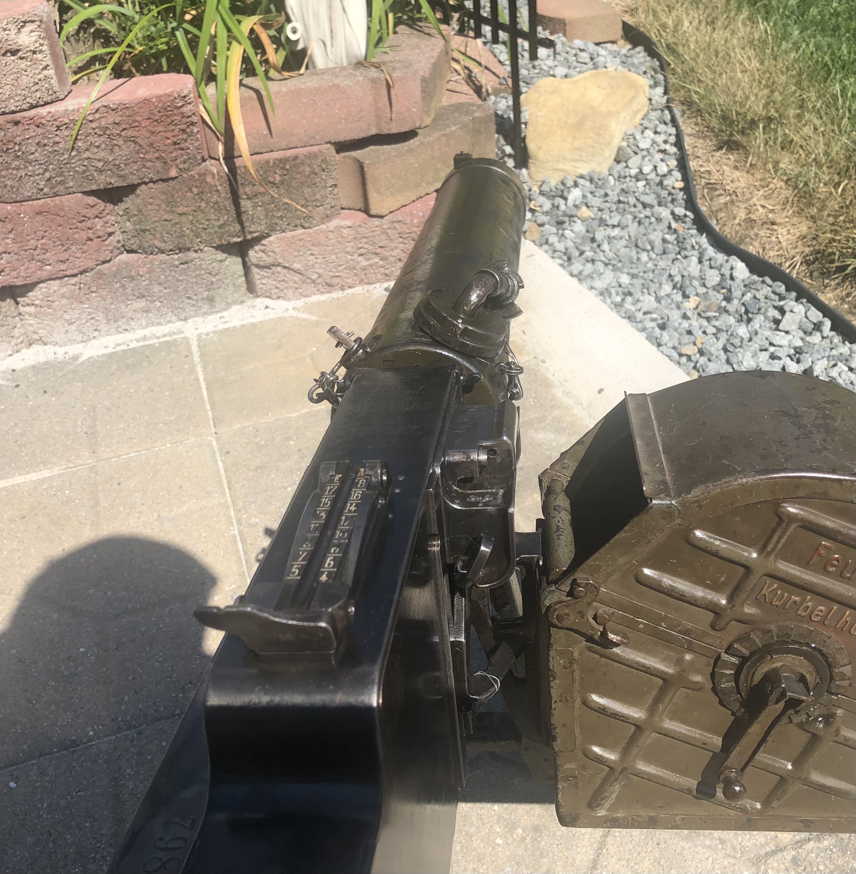

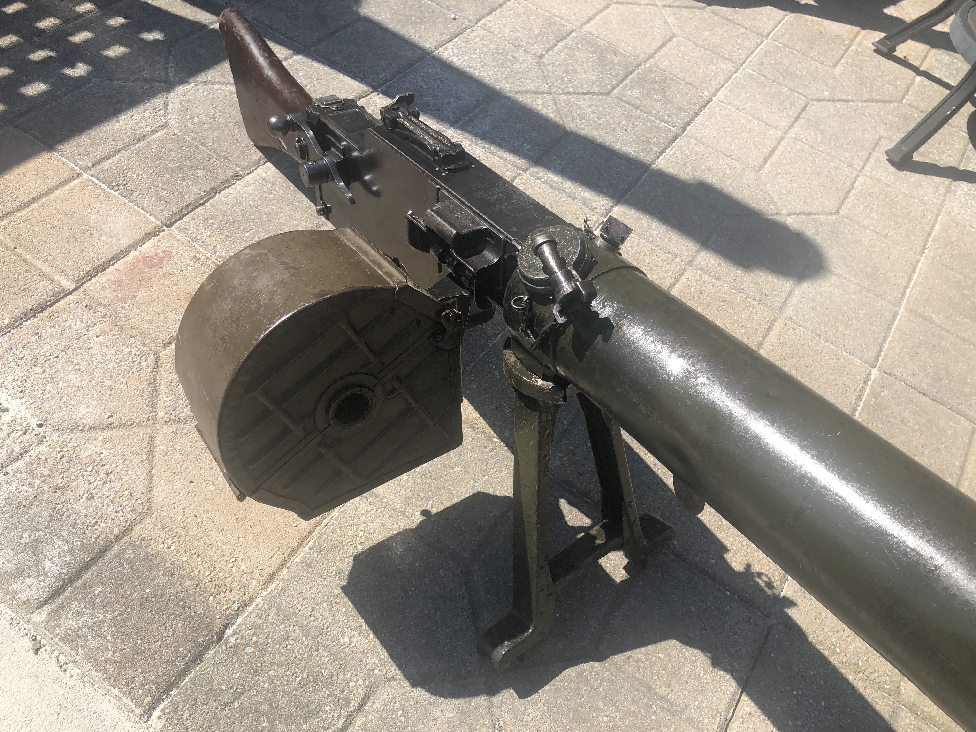

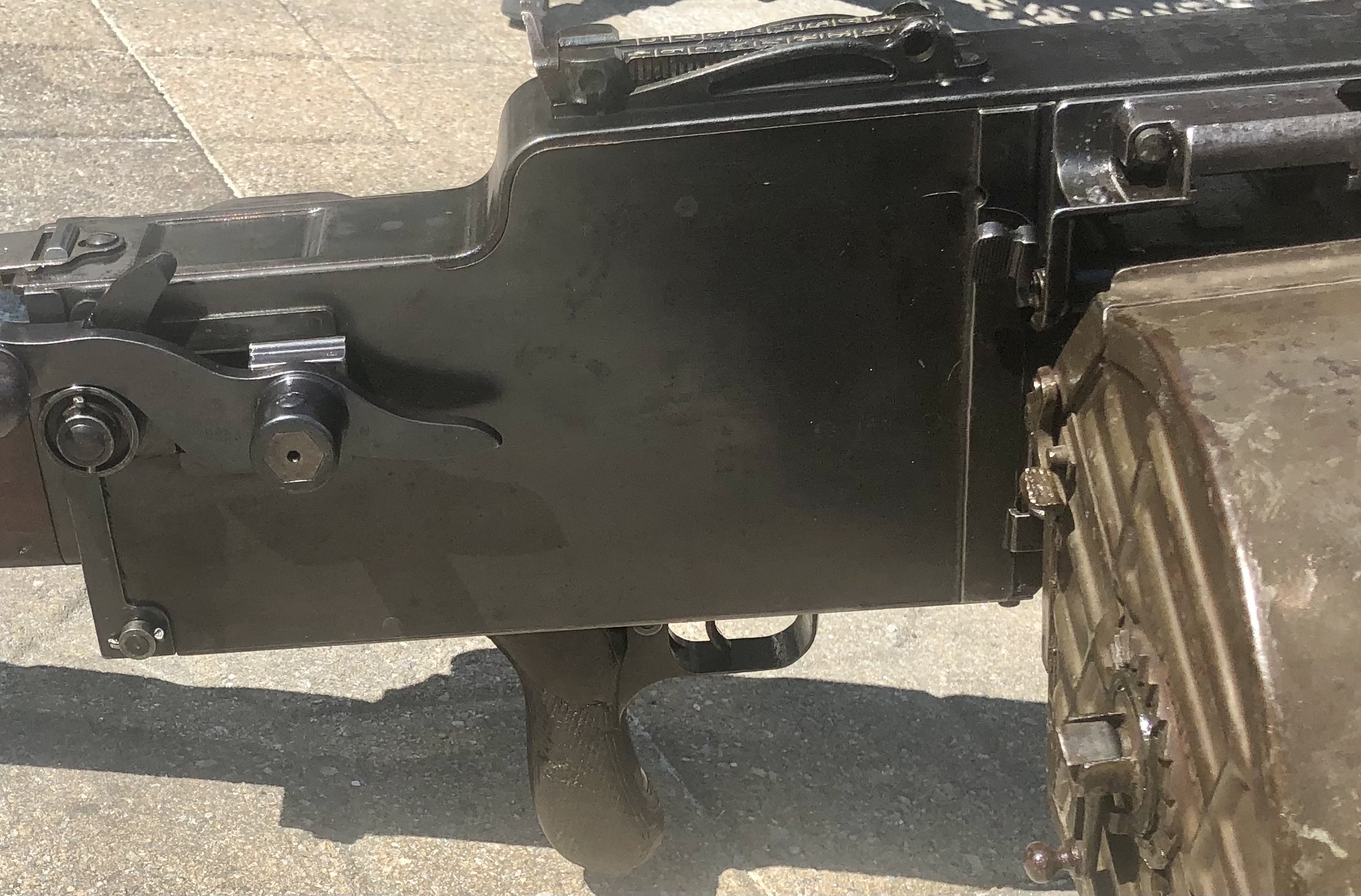

Re: MG08/15
Some photos, will try video next
