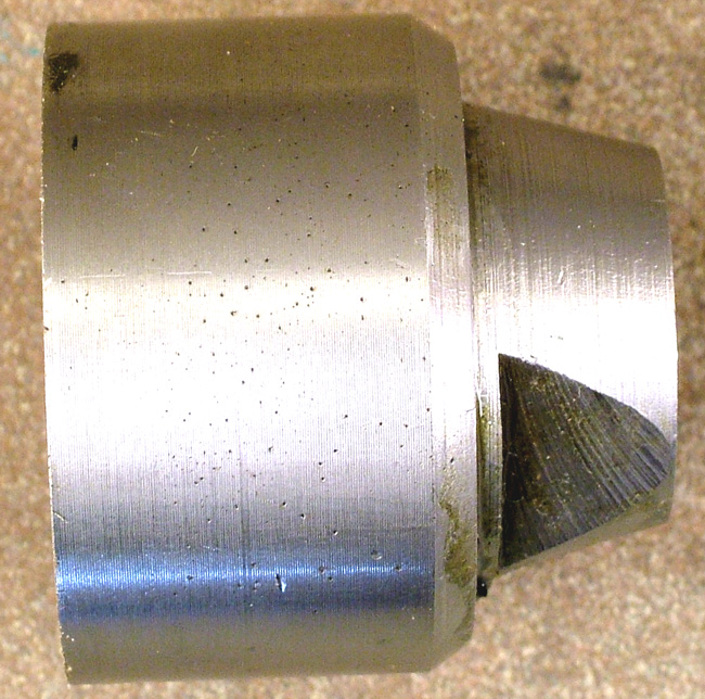

Curious that the book on "German Universal Machineguns" states that MG34's should have a 11 MM booster cone opening. How come so many parts sets and all the TNW guns come with a booster cone with a 9.5 MM opening? I have examined 4 MG34 parts sets and only the very early "Panzer" set had a boosted cone with a 11 MM opening. Also seems like many folks here have found 9.5 MM booster cones. Why are we seeing so many of what I thought would be a "rare" part used only with guns set up for light-weight ball training ammo?

I fully agree with Sledge and there must be an explanation why nearly all of the booster cones mentionned in this thread are the 9.5mm supposedly rare type. I have two booster cones too and both are 9.5mm. Shouldn't original German WWII issue booster cones be stamped with the usual Waffenamt and/or manufacturer's codes? Mines show no markings at all.

I am extremely curious about this myself since the cone I found in my C&R 1941 dfb was a 9.5 mm cone. The MG is 90% matching, with the buttstock, bolt and feed plate numbered to another MG.
I contacted Folke asking what damage would result using the 9.5 cone and this was his answer - "The unlocking cams take a beating if the bolt travels to the rear with too much force." I checked the cams and they did not appear to have any damage but to be on the safe side I bought an 11mm cone.

I have a semi 34 and I was having trouble with ejection issues. I replaced the cone with an 11mm one, and the gun ran better and the ejection issues disapeared. The cases dropped out the bottom rather than shotout the front.

m2ball wrote:I have a semi 34 and I was having trouble with ejection issues. I replaced the cone with an 11mm one, and the gun ran better and the ejection issues disapeared. The cases dropped out the bottom rather than shotout the front.
My TNW MG34 ejects the same way, slings the brass out the front for a good distance. It has a (nice) 9.5MM booster cone that closely resembles the one pictured on this thread. I am thinking of taking the one from my MG34 parts set (also 9.5MM) and having my local gunsmith turn it out to 10.5MM. That gives me a bit of a safety margin. If it is still a bit violent we can always open it up some more.

I have an original MG34 booster that has an exit hole that measures 10.5mm with a digital caliper. I thought the ww2 were 11.5? This one shows little to no wear?
