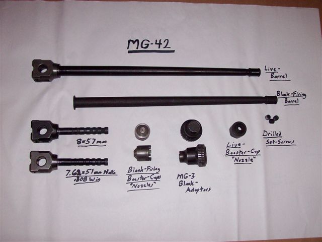

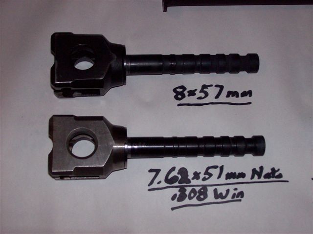

I thought that I would go in and add some photos of the different "systems" and parts used in Blank-Adapting the MG42/MG1/MG3 as shown below.
Maybe one of the "vendors" on the Board would like to do a "group-buy" of the 2-pcs. Blank-Barrel-Assemblies for Board-Members?

Guys.......I put that part of the "Thread" up as a remark .....and hope that one of the "barrel-makers"....or another vendor will see the thread and start asking about making these.
I can help and provide him (the selected "Barrel-Maker" that comes in with the lowest costs to our Board) with the required information "and" any assistance to Board-Members in helping to Blank-Adapt the MG42 or MG34 is free for the information....and help in trouble-shooting problem guns.
Presently, we are only "throwing" this out there for them to see the information...not taking a count for future sale......I am pretty-sure that he will require a minimum of two-used Barrel with good barrel-extensions for use in making these. (IE: 2 for MG42 and 2 for MG34....one for 8x57mm and the second for 7.62x51mmNATO/.308).

Blank adaptor.........
My son made me a blank adaptor as 'blanksguy' has talked about..It basically the same dementions as the 'nozzle', except it has a closed in bottom, and a 1/8th inch exit hole at top.........this is just right for the weaker Austrian blanks that are all over........
i tested it with a bunch of lubed belts, and 'Pirate's hammer kept hammering away.....
When i return, I'll let you'al know how the gun stood up to the intense fighting on der Russian front!!!!\
