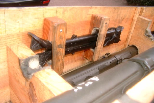

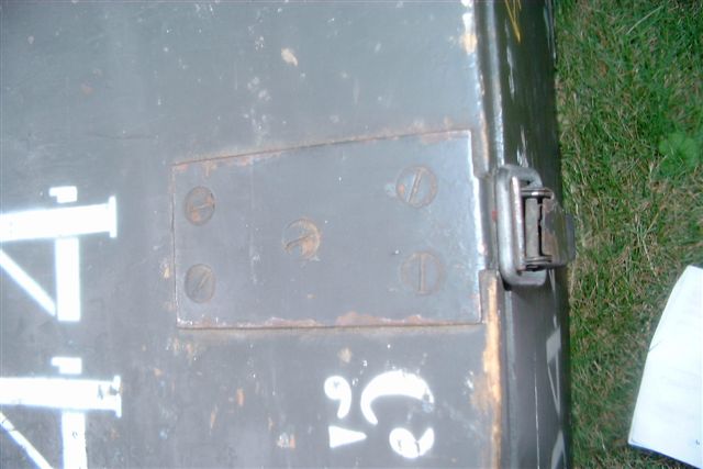

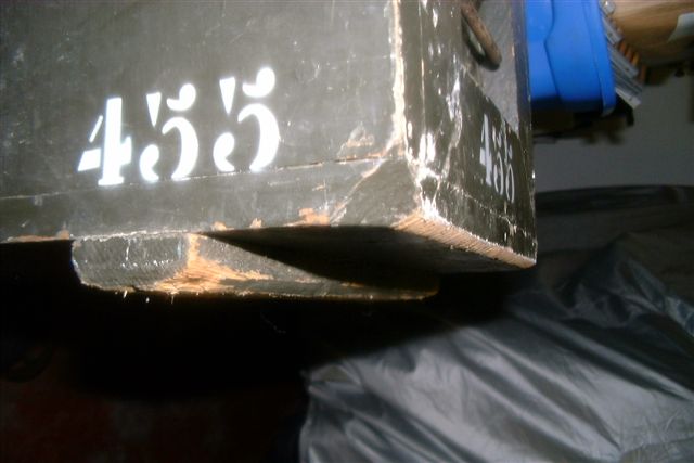

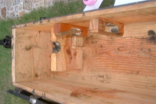

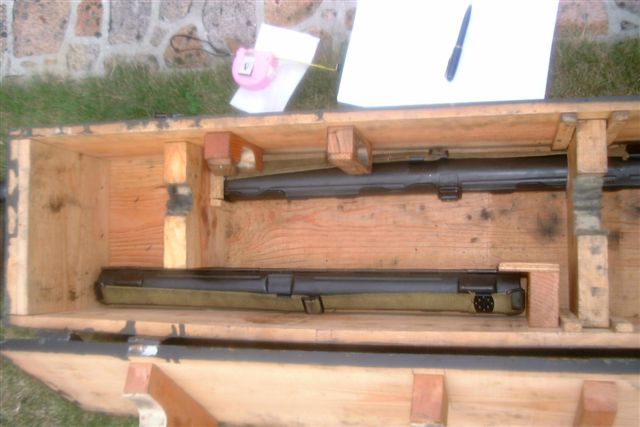

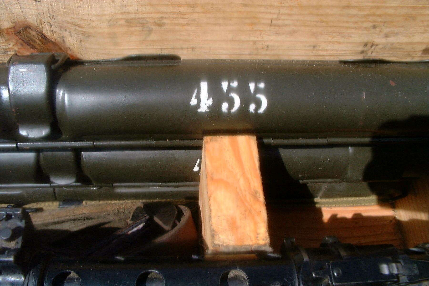

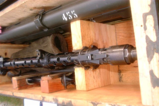

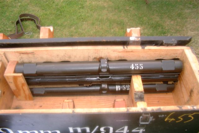

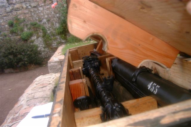

Here's the latest aquisition, a dewat contract 34 in its transit box. Most of these have been split up now so it was a nice find. Everything matches, except for one barrel tube. It appears it was last fired in 1970. I hope you like the pictures.

Transit box measurements.

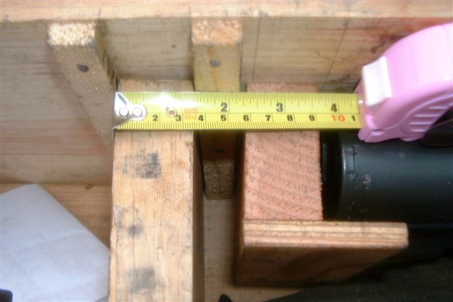

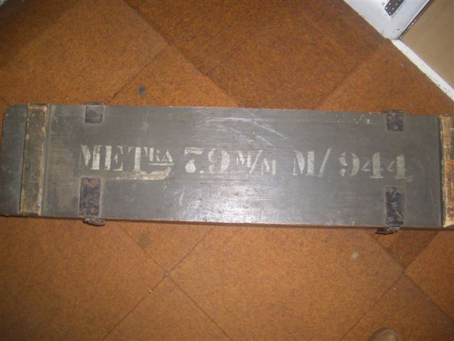

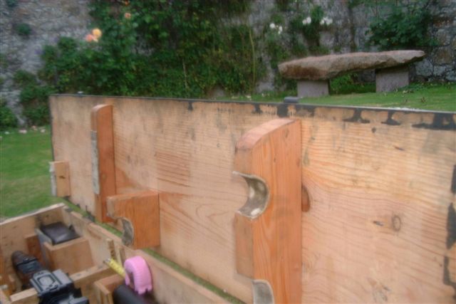

Firstly may I say that I am not the worlds best at decribing all the things you may want or need to be able to make your own transit box, but I have done my best to help all those who are interested in 34 diy. I have also taken a series of pictures which may help you in deciding where to put what and how in you box. Being only able to list a few pictures on the forum I have them on file and those who want them can email me for them directly at damienhorn@jerseymail.co.uk
So the basic sizes I thought you would need are length 121cm, width 28cm, hight 26cm. The wood looks to be 18mm thick approx.
The front, bottom, lid and back of the box are single pieces of wood. Each corner has the end cut off. The end panels are made up of one piece of wood with seperate pieces added to form an outer square making a recess for the carry handle.The outer square pieces are 55mm wide by 18mm. The ends are 38mm thick approx.
The inner measurements of the box are 25cm x 22.5cm x 113cm.
The hinges are 21cm in from the end the two strips of 55mm wood that run along the lid and the base are 7cm in from the end of the box.
I am sorry to put these details in such a confusing way but I have tried my best for you...I hope you can make something from them.

here are more pics from damien for this chest I am also makin this topic a stickie so it does not get lost
damien thantks for this contribution i know alot of guys want a chest that looks original and this wil help alot, now we just need you to find an mg42 chest
