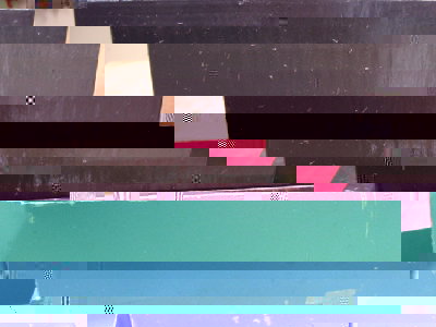

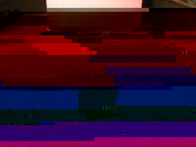

well I went to SW and had them mix up a quart. Once the kid called another store to find the color. (huh, RAL, never herd of it.) Mixed it up and brought it home. I think you are right, it's dead on!
Took some pic's with and without flash. It's a bit too shiny (Satin), but maybe an additive like Japan dryer or something can help with that.
