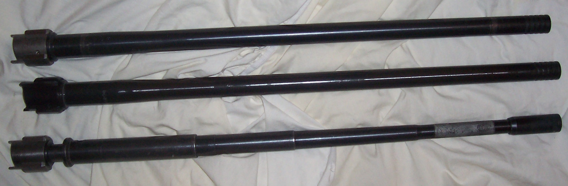

Pictured below are the three barrels I own. The first two are live fire barrels and the third is a late type blank firing barrel. Note the piece that interacts with the bold is slid out to show it is not directly attached. The blank fire barrel also has threads.
The second and third pics shows a closeup of the three barrel ends.
The first barrel has the following:
S
8358
2
7,91
P
13
DOT-40
5 WA on the barrel and 2 on the connector
The second barrel has the following:
5824
there is a small star shape and 2 BK? markings
0 WA on the barrel and 2 on the connector (and AGB?)
A reworked barrel???
The third barrel (blank):
two CNX
hth
3 WA
1 WA on the barrel and "BB"

All your barrels look, and are marked to what I am near certain are all original.
TMANNN34
barrel#2
Post by TMANNN34 »
Oops-forgot to add the star shape on barrel #2 is almost certainly an Isreali barrel(these are czech made usually-DOT marked) The isreali's stockpile was mostly from the DOT factory,made during wartime.
