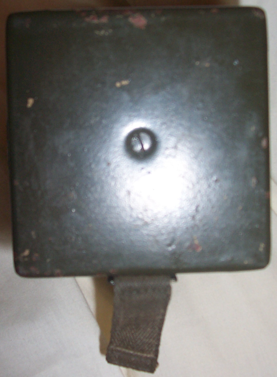

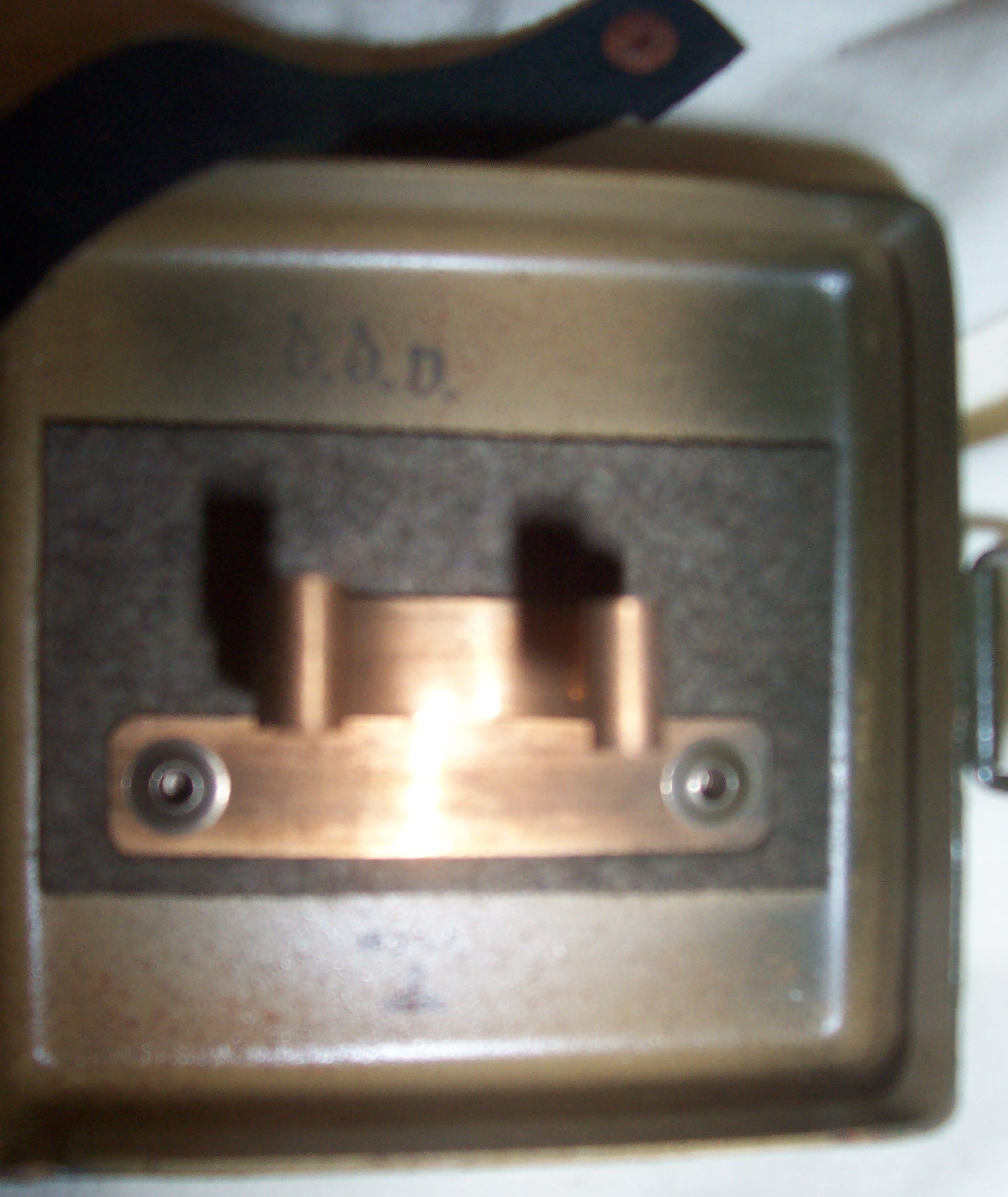

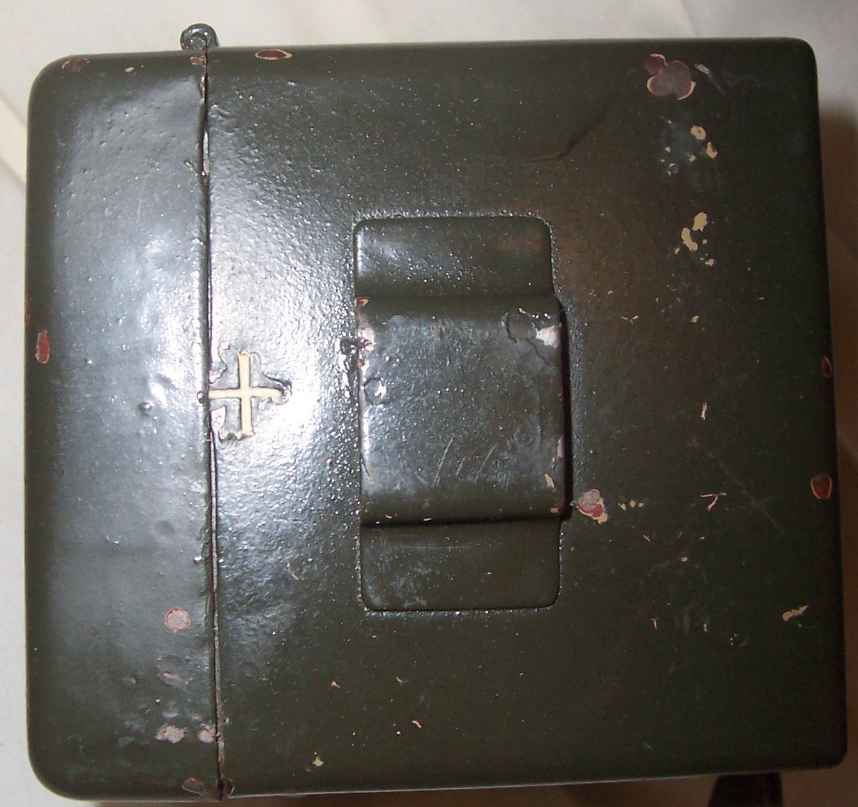

I just purchased a mg34 battery box from Alleghany Arsenal. Here is the original ad:
"MG-34 / MG-42 Lafette Battery box for illumination of optical site (No site or cord) Box is in very good condition with only some minor paint scrapes. Like new interior and has the ORIGINAL fiber insert that holds the battery which is almost always gone when you find these. Waffen ampted. $145. "
The box appears to have three layers of paint. A red primer, a second yellow and a third exterior dark green.
I have four questions:
(1) Is this an original battery box?
(2) How should the batteries be inserted?
(3) What is the center brass piece extending from the top of the lid?
(4) Do you think the exterior paint is postwar or original?
Here are the pictures.
Comments welcome.
Brian

- Battery Box top
- mg34 battery box pic1.JPG (119.85 KiB) Viewed 2570 times
- Battery box front
- mg34 battery box pic2.JPG (242.59 KiB) Viewed 2570 times
- Battery box side
- mg34 battery box pic3.JPG (357.06 KiB) Viewed 2570 times

Response to Battery box review
I was afraid it had been postwar converted as it did not match any other originals I saw. Thank you for the valuble input. If any one else has any comments please let me know. I feel as though Alleghany Arsenal misrepresented the item. I requested a picture from them before buying and they just sent it off without the picture. I dont know how difficult they will be to deal with.
I realize identifying paint from pictures is very difficult. I think it is postwar paint. The real test is this. Use acetone on a small area. If the top layer comes off easily it is likely postwar. When I stripped my barrel carrier it had postwar paint and the dark green easily came off leaving the german original yellow paint. The german paints dont seem to react with polar solvents such as acetone.

I can confirm much of what has been said above but I think that there is a silver lining to this.
I have one of these exact battery boxes from Alleghany, in addition to unmodified metal and leather boxes. In my opinion, this is a WWII box which has post war paint and the installation of a modified battery insert. Here is my take on it: you paid on the higher end of the scale for a bare box and it has been modified post war for a different type of battery. BUT, you may in fact come to really appreciate the post war battery set up.
The cardboard/fiber insert with brass leads and the brass retaining arms on the lid are the post war mods. Instead of using three European 4.5 volt batteries as original (which have to be special ordered here in the States), you can now use two D cell batteries to run the light. After cleaning a little surface rust off the rivets to the leads, two D cells worked like a charm in my modified box. For convenience alone, it's nice to have that set up if you ever intend to run the light.
And to add to my post:
From the looks of one of your photos, I think I can see the same type of rusted rivet on the fiber insert as I experienced. All it takes is a couple minutes with a dremel and brass wire brush bit. Once you clean the surface rust of those rivets, they will make good contact with the brass plates on the inside walls of the box.
Battery configuration: The D cells lay flat, oriented left-right so that the ends interface with the rivets and leads. Figure out which side is positive, and simply insert the batteries in the proper direction.
