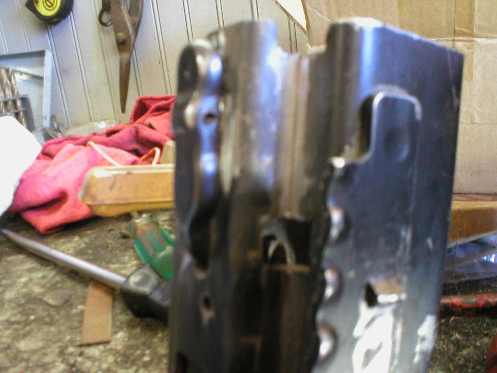

ok today while looking at my reciever I noticed a 1-2" crack in the reciever, my gun has 20 rounds through it in 8mm, we tigged the crack and ground it back down , guess I will see how long it lasts, i am not the only 1 with this problem , redjacketfirearms has had this problem on his full auto brp reciever, I will post pics later so you know what to look for as ours both cracked in the same place, just want you all to be aware of this so you can watch your guns also :?

let me say first I am not tryin to start any trouble just want guys to be aware of this "problem area" and it is not a welded area that is cracking, pic to follow
we also weled inside and outlooks like it was machined too thin for the charging handle

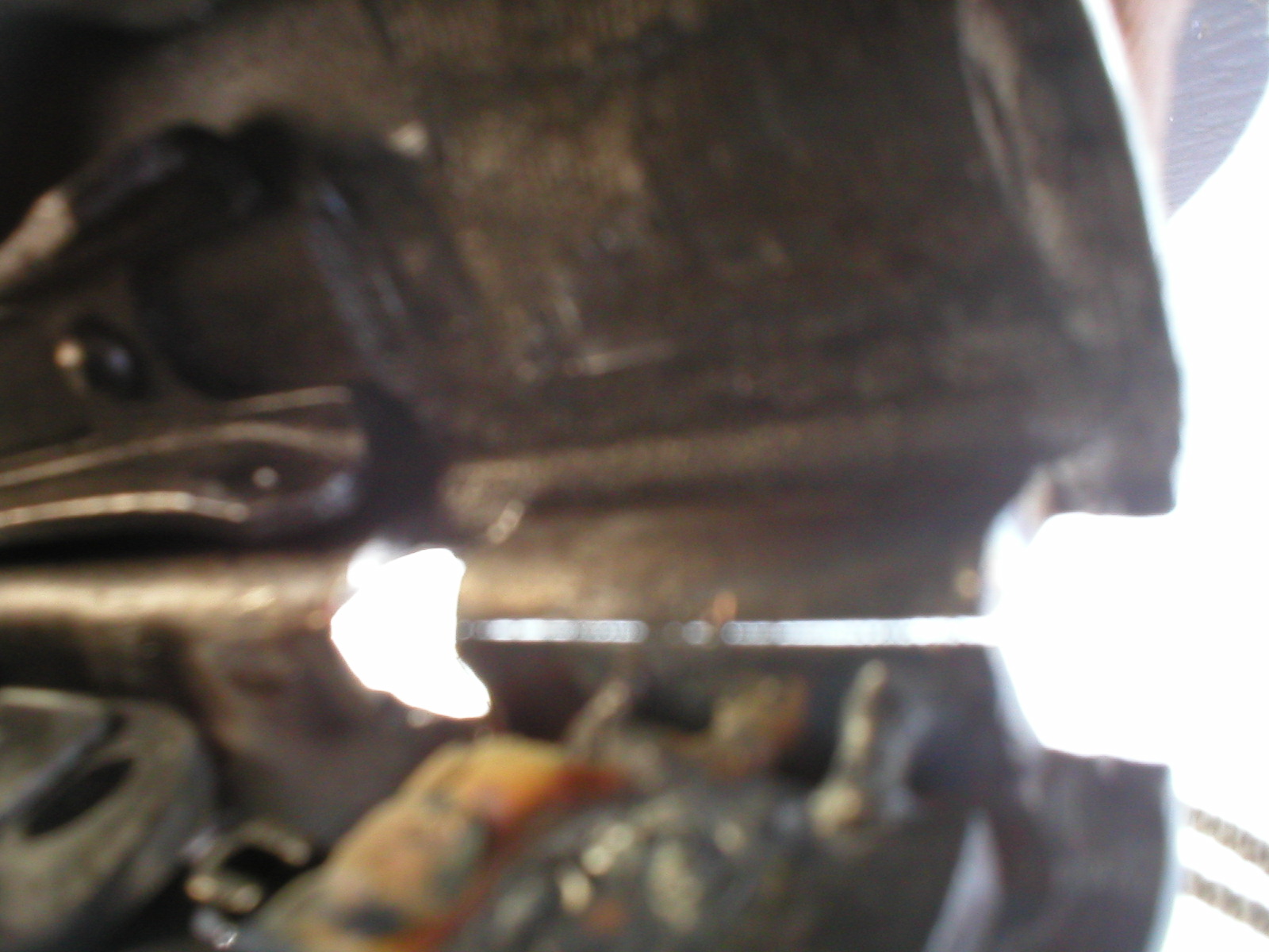

that is the right lower section of the recieverunder the rachet plate, i have welded and riveted in the lower buffer cam like original , i will need to weld the upper buffer cam as the rivets are already working loose, I will post a pic tonight of the cracked area from the outside so you can see wxactly where the crack forms

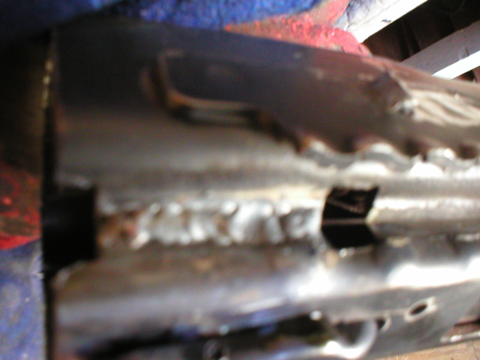

here are more pics, like i said when I looked at it with the cockin handle in i think the problem is the cocking slot is machined too deep causeing the area to be thin and fail

Well, for what it's worth, I have an original receiver section from a WWII gun, cracked it the same place. A design flaw, not a BRP flaw.
