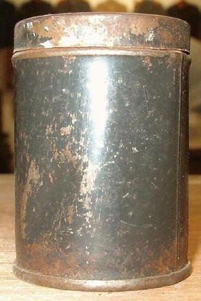

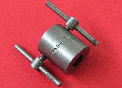

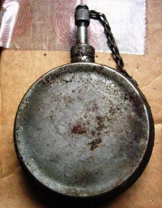

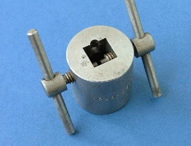

Can anybody tell me if these accesories are for a MG-34 ?
The seller indicate that are for mg-34 and from WWII.

MG-34 sighting tool ?

3. Mg-34 oil can without any mark.
4. Mg-34 cleaning tool ?
5. Mg -34 spare parts metal container ? (HFSC42H marked)
Item 1. Spare box. No known relevance to the MG34

Item 3. Oiler. Never seen a German WW2 oiler that looks like this.

Item 5. Sight adjusting tool. Yugoslavian postwar. Nothing similar was produced during WW2 by the Germans. This tool can be found represented as German WW2 time and time again on ebay, sold by a Canadian. This tool is of course sold by IMA as an Original! For more Yugo accessories try http://www.ima-usa.com/product_info.php ... ts_id/1078
I would recomend to drop all future dealings with this seller, as he is obviously running a scam!
