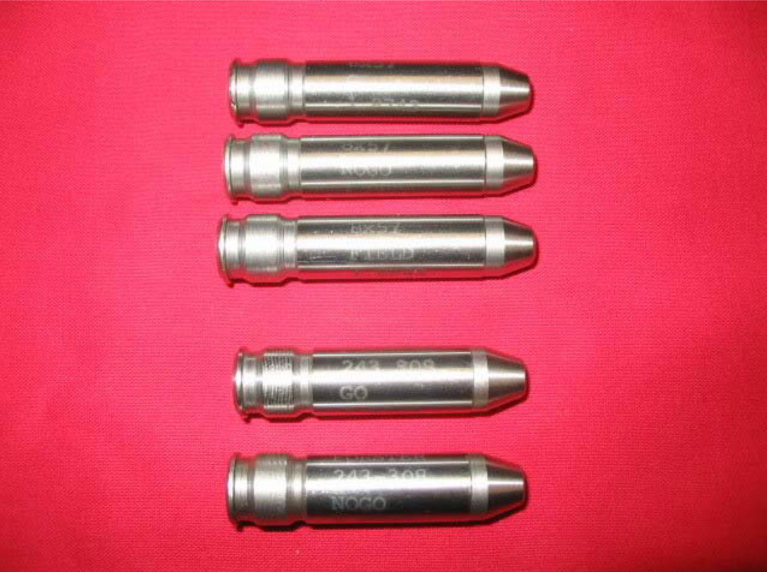

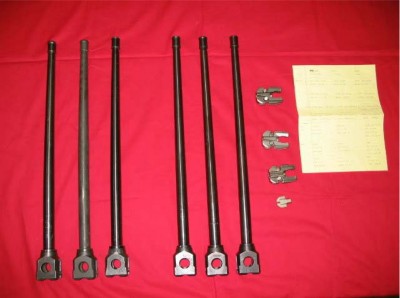

Examples of Forster Headspace Gages .
Top 3 are 8MM Go, No-Go, Field.
Bottom 2 are .308 Go, No-Go, Field is not pictured. (coming soon)

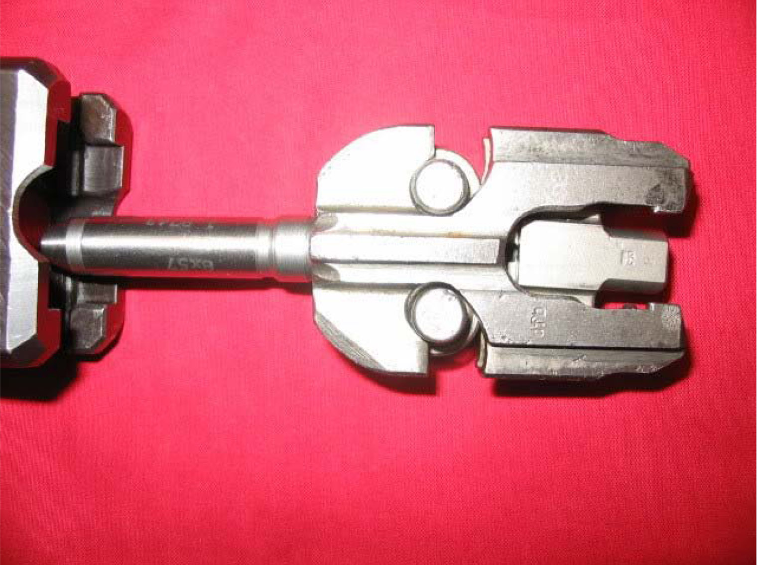

This picture is to illustrate that you should check all your barrels and bolt combinations and write down the results.
That way you can pair up good bolt to barrel combinations.

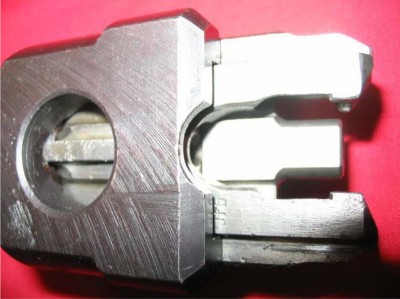

THE FOLLOWING TUTORIAL IS DONE IN 8MM

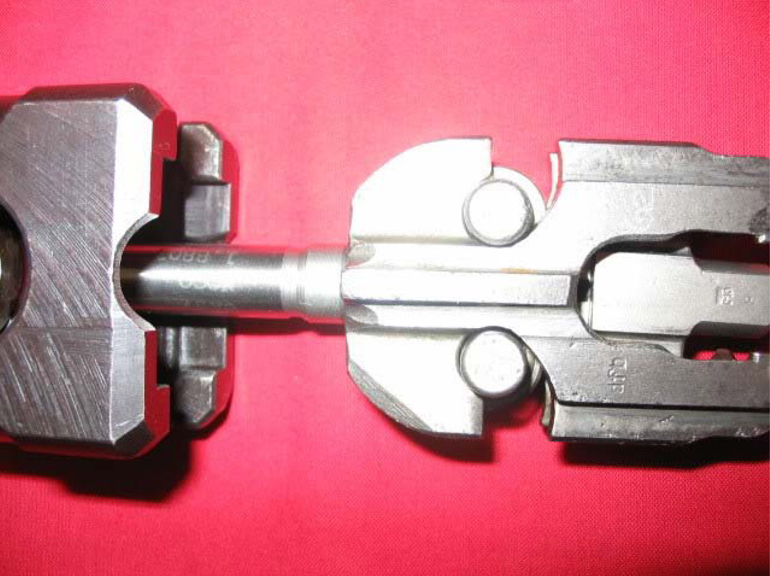

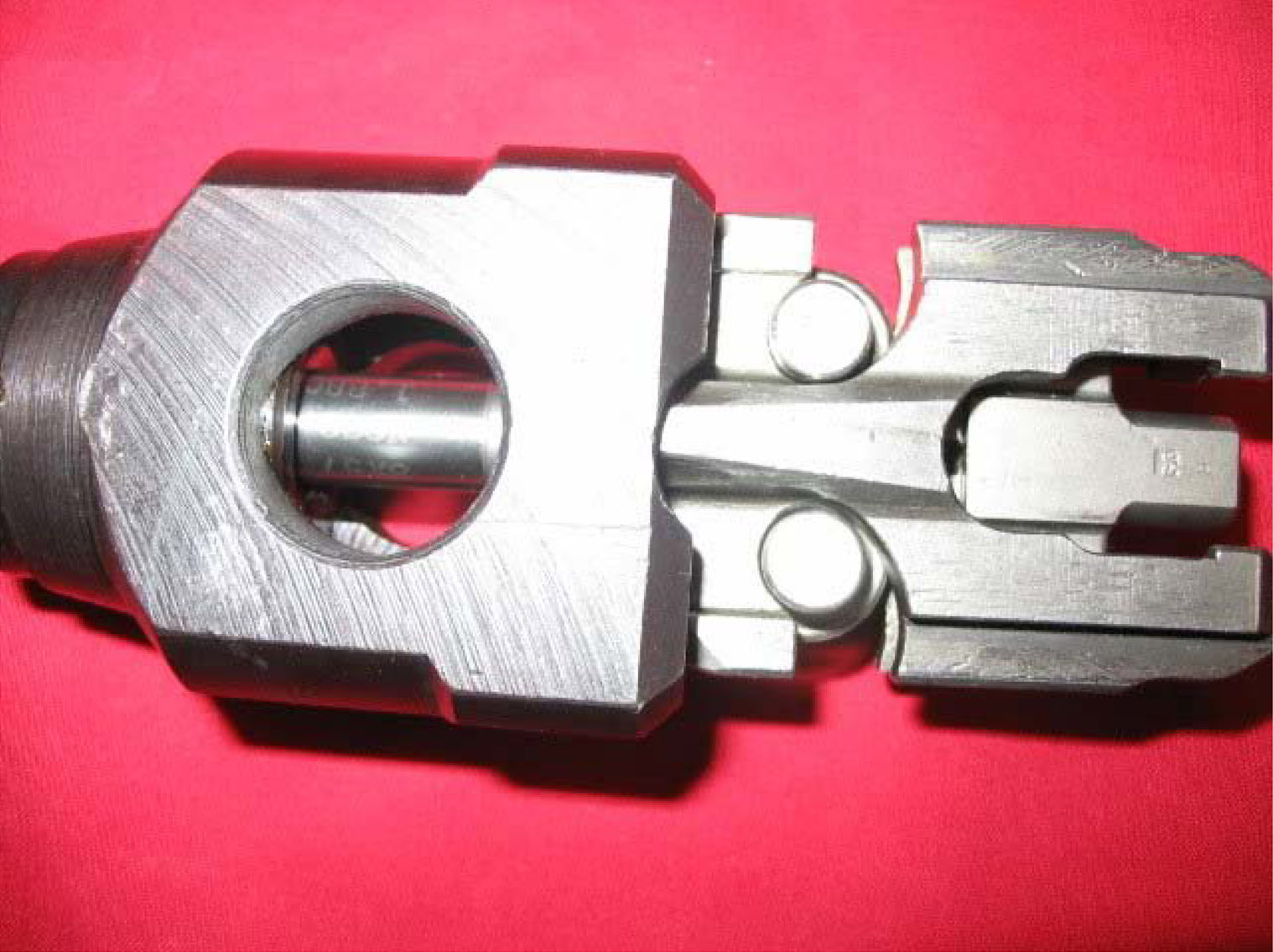

This is to illustrate the GO Gauge installed and the proper position of the Firing pin holder (real name is Striker Sleeve) and locking rollers in the bolt head. The striker sleeve is what pushes the locking rollers out into the barrel extension.
The striker sleeve should bottom out with the GO Gauge and the locking roller snap in and lock into the barrel extension.
This checks that there is not a short chamber situation.

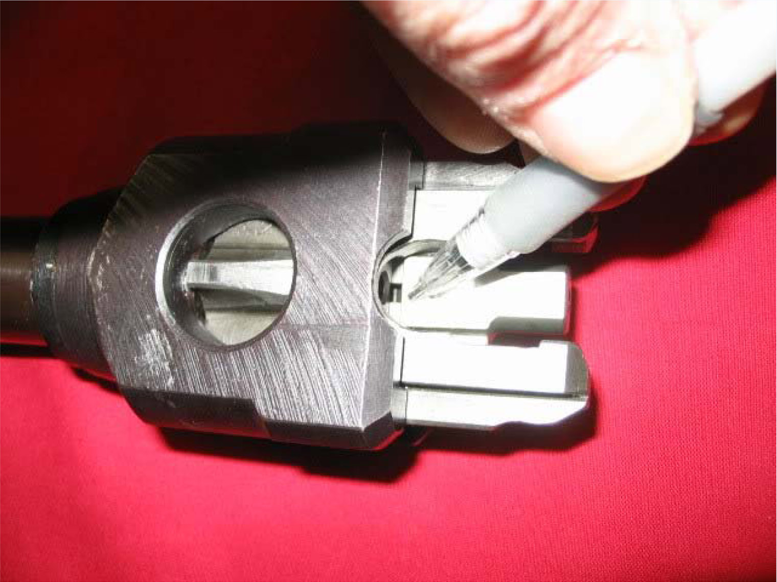

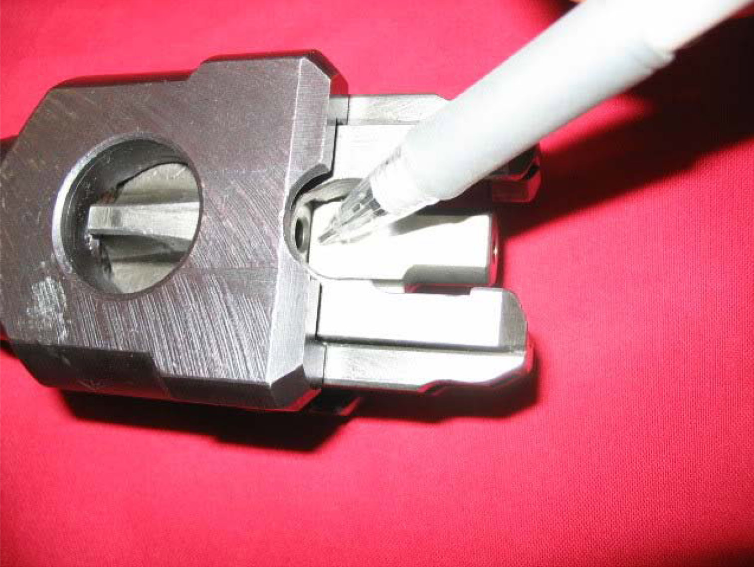

Next is to check that the chamber is not too long with the NO-GO Gauge.
This is to illustrate that the NO-GO Gauge should NOT GO or striker sleeve does not bottom out.
Check all your barrel bolt combinations to find suitable combinations that will work.

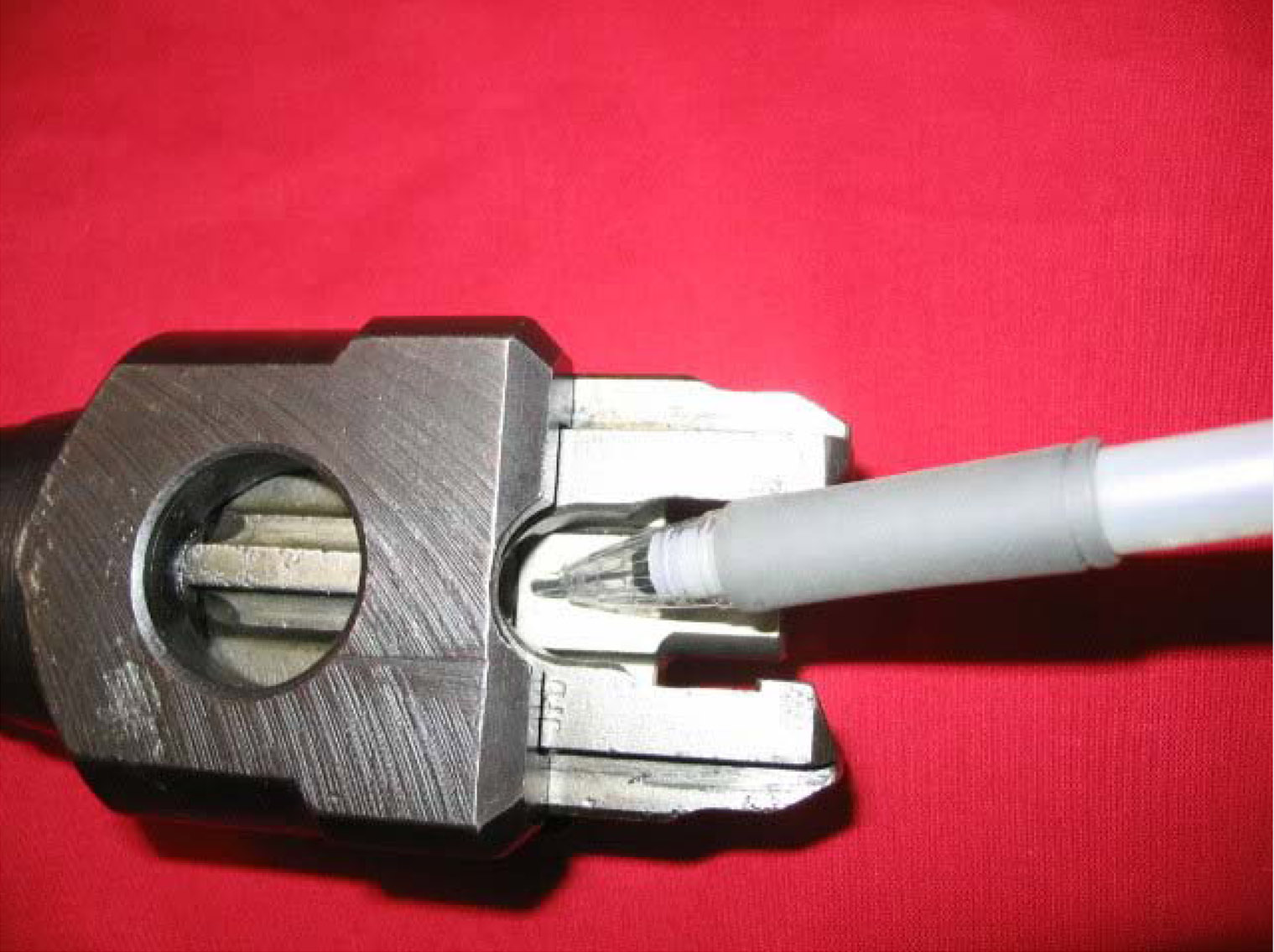

Do not despair if one or more of your barrels fails the NO-GO test. You can then check for serviceability with the Field Gauge which is the last ditch effort. However,
The Field Gauge SHOULD NOT GO/ OR BOTTOM OUT the Firing Pin holder/striker sleeve ( IE fully lock the bolt rollers.)
The next pictures are to illustrate a barrel that fails the NO-GO Gauge test with a NO-GO Gauge installed.
This picture illustrates this barrel failing the NO-GO Gauge[/color]test.
Note the Firing Pin holder/striker sleeve bottoming out with NO-GO Gauge installed.
This next picture is to illustrate that this barrel Passes the Field Gauge test by the Gauge NOT GOING . Which means the Striker sleeve NOT bottoming out. Thus this barrel would be safe to shoot with this bolt, But you would want to keep an eye on it.
